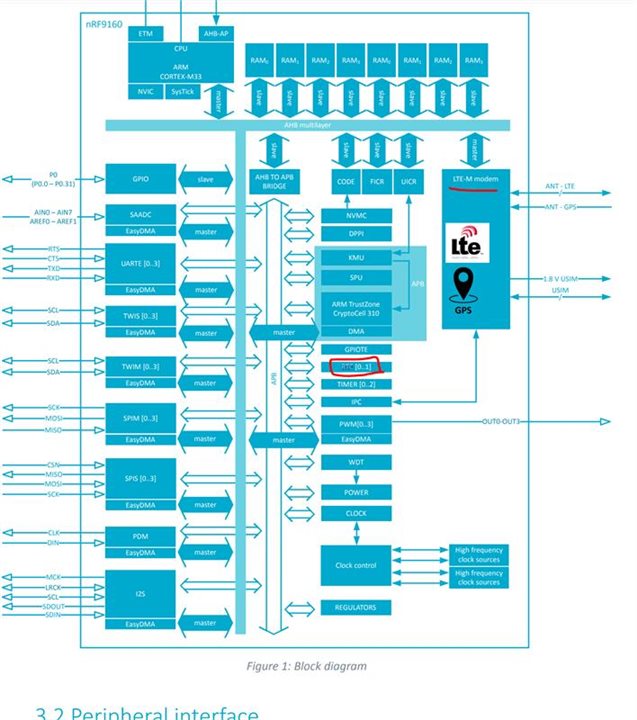

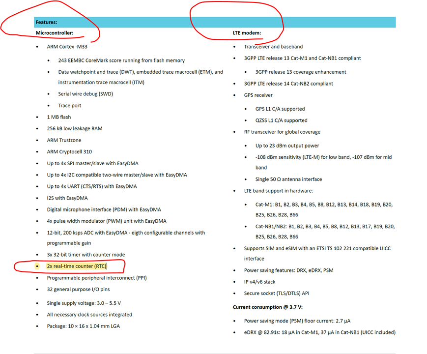

I used NRF9160 and i have some questions about it:
1. the internal rtc is accurate or not ? is calibrated or need to be calibrated every time?
2. this rtc is internal in application processor or is internal in lte modem/chip itself ? , so if rtc is internal just in application processor only , how commands like +CCLK which set/read the time works ? or when EMM information get from the MME to set the local time zone , how the lte modem know the time ? is there happen by communicating with the application processer ? or the modem/lte chip has its own internal rtc ?
i get confused !
