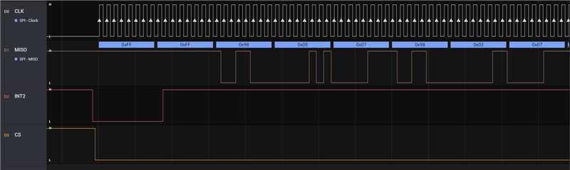

I am reading the FIFO buffer of a sensor via SPIM3 with nRF52840. What I want to do is that by the use of PPI, the start of the transmission (PPI channel 0, to TASKS_START / RESUME) is triggered by an event and also TASKS_SUSPEND (PPI Channel 1) for SPI is triggered by an event. The start works. The hardware CS flag goes low automatically using the hardware Select of SPIM3 and we read some bytes.
After about 10us, the other event occurs and should therefore suspend the SPI transmission shortly. But this does not happen, the transmission is continued until the buffer is empty which is not what I want. I checked that the PPI is implemented corrently - other tasks, except from TASKS_SUSPEND or TASKS_STOP, are succesfully performed.

  • Hi Torbjørn, thanks for the response.
    The second event which should trigger the suspend or stop only occurs as soon when the FIFO undergoes a certain watermark. Thus, when the event appears I can be quite sure that I am not trigggering start/resume and suspend/stop within the same byte but that at least one byte must have been read from the FIFO.
    I also attached two pictures which show the same situation (I only have a 4 Channel logic analyzer thats why it is 2 pictures). On the first picture one can see both INT1 and INT2 which are to trigger the tasks both on a rising edge - INT1 should start the SPI, which it obvously does, since the Clock starts and the CS pin goes down, and the INT2 rising edge should suspend it. On the second picture one can see the MISO pin and thus the reading of the bytes, and also that INT2 has the rising edge after one byte has been read.
    This is how I verify that the suspend is not working - despite the rising edge of INT2 the clock keeps toggling and we still read bytes.
    The frequency on the bus is 8Mbps, but also with 4Mbps it is not working.
    Do you have any ideas here?

    As you can see from the code I suspend the SPI 2 microseconds after it starts, and then I resume it 20 microseconds after. I verified the result on the scope:
    Are you sure that the pin events are actually received properly in your firmware, so that the SPIM tasks get activated properly?

    thank you for your example! I see that you took two different PPI channels for TASK_START and TASK_RESUME, triggered by different events.
    For me, I have only one event that should in the first run start the SPI transmission and then, after a suspend, should resume it. It's the same event. That's why I forked the PPI channel 0 to do both, START and RESUME.
    Is this maybe a problem?  That maybe the SUSPEND is directly cut off by the RESUME which was not triggered in the first run (because START was triggered instead)?
  • When I do not do the Fork, then the suspend is triggered: the CS pin stays low but the clock stops toggling.
    So I actually seem to have a problem with the resume now rather than with the suspend.
