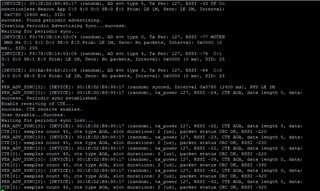

I have already made a transmitter (with an nRF52833) and a receiver (also nRF52833) and i can see the CTE send by my tw on my rx:

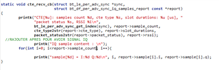

But now i want to print data IQ to do AOA so i have change the function called cte_recv_cb in the main like that (i have see this on another tickets) i have already include the hci.h:

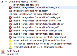

But now the program doesn't compile:
