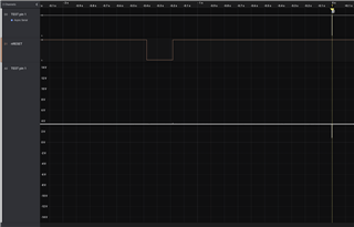

After a reset, all GPIOs are in reset-state, meaning that the pins will float.
What you're seeing is the time from CPU starts executing the first instruction, to the time it takes before the NRF_UARTE peripheral is configured.
To avoid this, I would recommend to consider using an external pull-up on the line(s) in question.

that is not normal, is is exactly same with 10k pull-up.
There should not be any Low level glitch on UART2 TX (used for SLM AT commands).

If I do not add an external pull, I see a similar ~1.1 ms low-period:
If I add a external pull up, I do not see this low period:
Håkon
I am sorry, I applied pull-up to wrong ping. I see same results as you now.
But with pull-up on UART2 TX, nRF9160 sustained power consuption after RESET increased from ~7uA to ~15uA.
