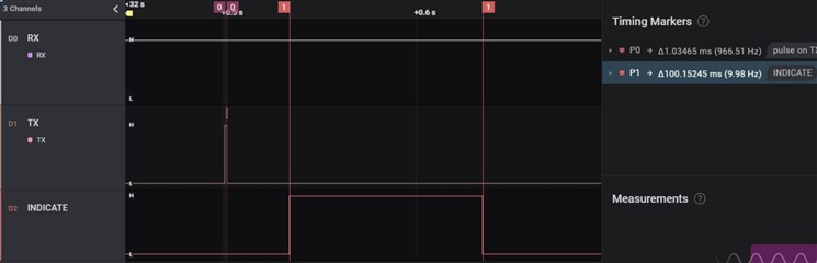

Serial LTE Modem app in NCS main - glitch on TX before INDICATE
NCS main, nRF9160 DK

There is unexpected glitch on TX just beforfe INDICATE is active:
    Are you referring to the TX line of UART2?
    Markus
  • Hello Markus,
    sure TX of UART2 used for AT commands of SLM.
    Michal
    Ok thanks, Michal! I will report this to the developers.
    Markus
  • Hello again Michal,
    How was the indicate pin triggered in this particular case?
    Markus
  • Hello again Markus,
    INDICATE was triggerd by this test scenario:
    .\nrf9160_tests.py test_attach
