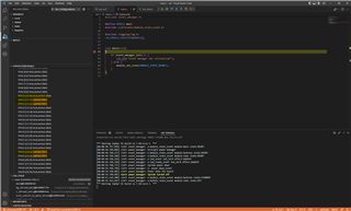

    I am not able to reproduce the problem at my end so far. I have a few questions though.
    In the screenshot that you shared, it looks like you are trying the default main file for caf and not the one that you have shared here in the ticket.
    Also, when you say that you are not able to latch separately when using a debugger, do you mean that when you start the debug session, you get this error? or only when you connect an external debugger this problem arises?

  • Yes the screenshot was for before the one I shared.
    The problem is still there if I start a debug session instead of just flashing the nRF52840dk board
    I used the built-in debugger on the board, not an external J-Link
    Board label is: PCA10056, 2.0.2, 2021.43, 683783911

  • Yes, and my attached project solves this for my purpose, as I can check the cause of wakeup. My application (not shown in the project) will go back to sleep if woken up by the wrong button. This works at least when not debugging (by checking and clearing the GPIO latch register). When debugging, any button wakeup will set the corresponding GPIO latch bit for ALL of the CAF buttons, while if I only flash instead of starting debugging, I can see via the GPIO latch register which button caused the wakeup.
    You can see this by looking at the NRF terminal output:
    1) Here I woke up the board by DK Button 1, not using debugger:
    *** Booting Zephyr OS build v2.7.99-ncs1-1 ***
    [00:00:00.375,671] <inf> main: NRF_P0->LATCH, at wakeup = 0x00000800, after clear = 0x00000000
    As you will see, the latch value marked in GREEN indicates the bit set for DK Button 1
    2) Here I woke up the board by DK Button 4, not using debugger:
    [00:00:00.380,859] <inf> main: NRF_P0->LATCH, at wakeup = 0x02000000, after clear = 0x00000000
    As you will see, the latch value marked in GREEN indicates the bit set for DK Button 4
    3) Here I woke up the board by DK Button 4, and using debugger:
    [00:00:00.379,150] <inf> main: NRF_P0->LATCH, at wakeup = 0x03001800, after clear = 0x00000000
    As you will see, the latch value marked in RED indicates the bits set for all 4 DK buttons.
    But as I mentioned earlier, this is only a problem when running a debug session.
    You may close this ticket.
