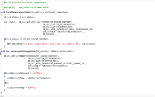

Issue: Not able to see data packet on the sniffer when I send the data to gateway using ZB_ZCL_SET_ATTRIBUTE / zb_zcl_set_attr_val
  • I use the Macro ZB_ZCL_SET_ATTRIBUTE()  & function zb_zcl_set_attr_val() to set the attributes so that the data can be sent over the gateway.

  • please find the snapshot of my function below,
 Do I have to do any other operation?

  • Hi Shivaprasad,
    ZB_ZCL_SET_ATTRIBUTE and zb_zcl_set_attr_val do not send the attribute to a remote device. They update the value of the attribute on the local device. What you see in the sniffer logs are attribute reports, which are sent periodically and regardless of changes to the attribute value. If you want the thermostat to send the updated value when the attribute value is changed instead of (or in addition to) periodically you can configure the attribute reporting to report on value change, using the reportable change field.
    We do not have any examples using reportable change attribute reporting, but this comment by Edvin shows what he did to get this with the CLI and multi sensor examples.
