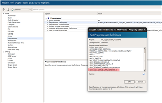

  • Hi Vidar,
    I failed to understand correctly your initial answer.
    After reading again and again the crypto backends related documentation I was sure that you mentioned the compilation flags to be used while building the uECC library. But after I looked more carefully I see that the same flags have to be used also in the project using the uECC library. And that is because uECC_VLI_NATIVE_LITTLE_ENDIAN flag is also used by the micro-ecc backend which is compiled as a part of the project.
    Please update the documentation of the backend.
    Now while compiling my project with uECC the pairing works.
