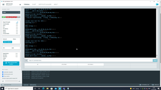

Hi Jonathan,
I just get board few days ago, and i don't have any experience with nRF board so 1st time i build and flash Hello_Wold program and getting output on LTE link monito. Now want to get GPS coordinate without insert SIM card so as you said i build and flash sample program and seeing output on LTE link monitor, it's showing
not getting GPS coordinate, please help for getting it.
thanks & Regards
S
2022-05-23T09:37:35.716Z DEBUG modem << *** Booting Zephyr OS build v2.7.99-ncs1-1 *** 2022-05-23T09:37:35.729Z DEBUG modem << Flash regionsDomainPermissions 2022-05-23T09:37:35.734Z DEBUG modem << 00 01 0x00000 0x10000 Securerwxl 2022-05-23T09:37:35.740Z DEBUG modem << 02 31 0x10000 0x100000 Non-Securerwxl 2022-05-23T09:37:35.742Z DEBUG modem << Non-secure callable region 0 placed in flash region 1 with size 32. 2022-05-23T09:37:35.783Z DEBUG modem << SRAM regionDomainPermissions 2022-05-23T09:37:35.789Z DEBUG modem << 2022-05-23T09:37:35.796Z DEBUG modem << 00 03 0x00000 0x08000 Securerwxl 2022-05-23T09:37:35.798Z DEBUG modem << 04 31 0x08000 0x40000 Non-Securerwxl 2022-05-23T09:37:35.801Z DEBUG modem << PeripheralDomainStatus 2022-05-23T09:37:35.803Z DEBUG modem << 00 NRF_P0 Non-SecureOK 2022-05-23T09:37:35.804Z DEBUG modem << 01 NRF_CLOCK Non-SecureOK 2022-05-23T09:37:35.812Z DEBUG modem << 02 NRF_RTC0 Non-SecureOK 2022-05-23T09:37:35.814Z DEBUG modem << 03 NRF_RTC1 Non-SecureOK 2022-05-23T09:37:35.817Z DEBUG modem << 04 NRF_NVMC Non-SecureOK 2022-05-23T09:37:35.818Z DEBUG modem << 05 NRF_UARTE1 Non-SecureOK 2022-05-23T09:37:35.819Z DEBUG modem << 06 NRF_UARTE2 SecureSKIP 2022-05-23T09:37:35.821Z DEBUG modem << 07 NRF_TWIM2 Non-SecureOK 2022-05-23T09:37:35.829Z DEBUG modem << 08 NRF_SPIM3 Non-SecureOK 2022-05-23T09:37:35.833Z DEBUG modem << 09 NRF_TIMER0 Non-SecureOK 2022-05-23T09:37:35.834Z DEBUG modem << 10 NRF_TIMER1 Non-SecureOK 2022-05-23T09:37:35.835Z DEBUG modem << 11 NRF_TIMER2 Non-SecureOK 2022-05-23T09:37:35.837Z DEBUG modem << 2022-05-23T09:37:35.839Z DEBUG modem << 12 NRF_SAADC Non-SecureOK 2022-05-23T09:37:35.848Z DEBUG modem << 13 NRF_PWM0 Non-SecureOK 2022-05-23T09:37:35.850Z DEBUG modem << 14 NRF_PWM1 Non-SecureOK 2022-05-23T09:37:35.852Z DEBUG modem << 15 NRF_PWM2 Non-SecureOK 2022-05-23T09:37:35.853Z DEBUG modem << 16 NRF_PWM3 Non-SecureOK 2022-05-23T09:37:35.855Z DEBUG modem << 17 NRF_WDT Non-SecureOK 2022-05-23T09:37:35.865Z DEBUG modem << 18 NRF_IPC Non-SecureOK 2022-05-23T09:37:35.868Z DEBUG modem << 19 NRF_VMC Non-SecureOK 2022-05-23T09:37:35.869Z DEBUG modem << 20 NRF_FPU Non-SecureOK 2022-05-23T09:37:35.870Z DEBUG modem << 21 NRF_EGU0 Non-SecureOK 2022-05-23T09:37:35.877Z DEBUG modem << 22 NRF_EGU1 Non-SecureOK 2022-05-23T09:37:35.880Z DEBUG modem << 23 NRF_EGU2 Non-SecureOK 2022-05-23T09:37:35.881Z DEBUG modem << 24 NRF_EGU3 Non-SecureOK 2022-05-23T09:37:35.883Z DEBUG modem << 25 NRF_EGU4 Non-SecureOK 2022-05-23T09:37:35.886Z DEBUG modem << 26 NRF_EGU5 Non-SecureOK 2022-05-23T09:37:35.888Z DEBUG modem << 27 NRF_DPPIC Non-SecureOK 2022-05-23T09:37:35.897Z DEBUG modem << 28 NRF_REGULATORS Non-SecureOK 2022-05-23T09:37:35.899Z DEBUG modem << 29 NRF_PDM Non-SecureOK 2022-05-23T09:37:35.902Z DEBUG modem << 30 NRF_I2S Non-SecureOK 2022-05-23T09:37:35.904Z DEBUG modem << 31 NRF_GPIOTE1 Non-SecureOK 2022-05-23T09:37:35.912Z DEBUG modem << SPM: NS image at 0x10000 2022-05-23T09:37:35.914Z DEBUG modem << SPM: NS MSP at 0x2000eb28 2022-05-23T09:37:35.916Z DEBUG modem << SPM: NS reset vector at 0x14389 2022-05-23T09:37:35.918Z DEBUG modem << SPM: prepare to jump to Non-Secure image. 2022-05-23T09:37:36.471Z DEBUG modem << *** Booting Zephyr OS build v2.7.99-ncs1-1 *** 2022-05-23T09:37:36.486Z DEBUG modem << [00:00:00.556,610] [0m<inf> gnss_sample: Starting GNSS sample[0m 2022-05-23T09:37:37.455Z DEBUG modem << [1;1H[2JTracking: 0 Using: 0 Unhealthy: 0 2022-05-23T09:37:37.469Z DEBUG modem << ----------------------------------- 2022-05-23T09:37:37.482Z DEBUG modem << Seconds since last fix: 0 2022-05-23T09:37:37.485Z DEBUG modem << Searching [|] 2022-05-23T09:37:37.487Z DEBUG modem << NMEA strings: 2022-05-23T09:37:37.490Z DEBUG modem << $GPGGA,000001.00,,,,,0,,99.99,,M,,M,,*67 2022-05-23T09:37:37.492Z DEBUG modem << $GPGLL,,,,,000001.00,V,N*4B 2022-05-23T09:37:37.508Z DEBUG modem << $GPGSA,A,1,,,,,,,,,,,,,99.99,99.99,99.99,1*2D 2022-05-23T09:37:37.509Z DEBUG modem << $GPGSV,1,1,0,,,,,,,,,,,,,,,,,1*54 2022-05-23T09:37:37.510Z DEBUG modem << $GPRMC,000001.00,V,,,,,,,060180,,,N,V*09 2022-05-23T09:37:38.456Z DEBUG modem << [1;1H[2JTracking: 0 Using: 0 Unhealthy: 0 2022-05-23T09:37:38.471Z DEBUG modem << ----------------------------------- 2022-05-23T09:37:38.484Z DEBUG modem << Seconds since last fix: 1 2022-05-23T09:37:38.487Z DEBUG modem << Searching [/] 2022-05-23T09:37:38.490Z DEBUG modem << NMEA strings: 2022-05-23T09:37:38.492Z DEBUG modem << $GPGGA,000002.00,,,,,0,,99.99,,M,,M,,*64 2022-05-23T09:37:38.494Z DEBUG modem << $GPGLL,,,,,000002.00,V,N*48 2022-05-23T09:37:38.509Z DEBUG modem << $GPGSA,A,1,,,,,,,,,,,,,99.99,99.99,99.99,1*2D 2022-05-23T09:37:38.511Z DEBUG modem << $GPGSV,1,1,0,,,,,,,,,,,,,,,,,1*54 2022-05-23T09:37:38.512Z DEBUG modem << $GPRMC,000002.00,V,,,,,,,060180,,,N,V*0A 2022-05-23T09:37:39.456Z DEBUG modem << [1;1H[2JTracking: 0 Using: 0 Unhealthy: 0 2022-05-23T09:37:39.464Z DEBUG modem << ----------------------------------- 2022-05-23T09:37:39.465Z DEBUG modem << Seconds since last fix: 2 2022-05-23T09:37:39.467Z DEBUG modem << Searching [-] 2022-05-23T09:37:39.469Z DEBUG modem << NMEA strings: 2022-05-23T09:37:39.470Z DEBUG modem << $GPGGA,000003.00,,,,,0,,99.99,,M,,M,,*65 2022-05-23T09:37:39.478Z DEBUG modem << $GPGLL,,,,,000003.00,V,N*49 2022-05-23T09:37:39.480Z DEBUG modem << $GPGSA,A,1,,,,,,,,,,,,,99.99,99.99,99.99,1*2D 2022-05-23T09:37:39.481Z DEBUG modem << $GPGSV,1,1,0,,,,,,,,,,,,,,,,,1*54 2022-05-23T09:37:39.483Z DEBUG modem << $GPRMC,000003.00,V,,,,,,,060180,,,N,V*0B 2022-05-23T09:37:40.456Z DEBUG modem << [1;1H[2JTracking: 0 Using: 0 Unhealthy: 0 2022-05-23T09:37:40.469Z DEBUG modem << ----------------------------------- 2022-05-23T09:37:40.487Z DEBUG modem << Seconds since last fix: 3 2022-05-23T09:37:40.490Z DEBUG modem << Searching [\] 2022-05-23T09:37:40.492Z DEBUG modem << NMEA strings: 2022-05-23T09:37:40.494Z DEBUG modem << $GPGGA,000004.00,,,,,0,,99.99,,M,,M,,*62 2022-05-23T09:37:40.496Z DEBUG modem << $GPGLL,,,,,000004.00,V,N*4E 2022-05-23T09:37:40.513Z DEBUG modem << $GPGSA,A,1,,,,,,,,,,,,,99.99,99.99,99.99,1*2D 2022-05-23T09:37:40.515Z DEBUG modem << $GPGSV,1,1,0,,,,,,,,,,,,,,,,,1*54 2022-05-23T09:37:40.516Z DEBUG modem << $GPRMC,000004.00,V,,,,,,,060180,,,N,V*0C 2022-05-23T09:37:41.456Z DEBUG modem << [1;1H[2JTracking: 0 Using: 0 Unhealthy: 0 2022-05-23T09:37:41.471Z DEBUG modem << ----------------------------------- 2022-05-23T09:37:41.488Z DEBUG modem << Seconds since last fix: 4 2022-05-23T09:37:41.491Z DEBUG modem << Searching [|] 2022-05-23T09:37:41.493Z DEBUG modem << NMEA strings: 2022-05-23T09:37:41.495Z DEBUG modem << $GPGGA,000005.00,,,,,0,,99.99,,M,,M,,*63 2022-05-23T09:37:41.498Z DEBUG modem << $GPGLL,,,,,000005.00,V,N*4F 2022-05-23T09:37:41.501Z DEBUG modem << $GPGSA,A,1,,,,,,,,,,,,,99.99,99.99,99.99,1*2D 2022-05-23T09:37:41.510Z DEBUG modem << $GPGSV,1,1,0,,,,,,,,,,,,,,,,,1*54 2022-05-23T09:37:41.511Z DEBUG modem << $GPRMC,000005.00,V,,,,,,,060180,,,N,V*0D 2022-05-23T09:37:42.456Z DEBUG modem << [1;1H[2JTracking: 0 Using: 0 Unhealthy: 0 2022-05-23T09:37:42.469Z DEBUG modem << ----------------------------------- 2022-05-23T09:37:42.484Z DEBUG modem << Seconds since last fix: 5 2022-05-23T09:37:42.487Z DEBUG modem << Searching [/] 2022-05-23T09:37:42.489Z DEBUG modem << NMEA strings: 2022-05-23T09:37:42.492Z DEBUG modem << $GPGGA,000006.00,,,,,0,,99.99,,M,,M,,*60 2022-05-23T09:37:42.493Z DEBUG modem << $GPGLL,,,,,000006.00,V,N*4C 2022-05-23T09:37:42.505Z DEBUG modem << $GPGSA,A,1,,,,,,,,,,,,,99.99,99.99,99.99,1*2D 2022-05-23T09:37:42.507Z DEBUG modem << $GPGSV,1,1,0,,,,,,,,,,,,,,,,,1*54 2022-05-23T09:37:42.508Z DEBUG modem << $GPRMC,000006.00,V,,,,,,,060180,,,N,V*0E 2022-05-23T09:37:43.456Z DEBUG modem << [1;1H[2JTracking: 0 Using: 0 Unhealthy: 0 2022-05-23T09:37:43.470Z DEBUG modem << ----------------------------------- 2022-05-23T09:37:43.485Z DEBUG modem << Seconds since last fix: 6 2022-05-23T09:37:43.489Z DEBUG modem << Searching [-] 2022-05-23T09:37:43.491Z DEBUG modem << NMEA strings: 2022-05-23T09:37:43.496Z DEBUG modem << $GPGGA,000007.00,,,,,0,,99.99,,M,,M,,*61 2022-05-23T09:37:43.498Z DEBUG modem << $GPGLL,,,,,000007.00,V,N*4D 2022-05-23T09:37:43.512Z DEBUG modem << $GPGSA,A,1,,,,,,,,,,,,,99.99,99.99,99.99,1*2D 2022-05-23T09:37:43.514Z DEBUG modem << $GPGSV,1,1,0,,,,,,,,,,,,,,,,,1*54 2022-05-23T09:37:43.515Z DEBUG modem << $GPRMC,000007.00,V,,,,,,,060180,,,N,V*0F 2022-05-23T09:37:44.456Z DEBUG modem << [1;1H[2JTracking: 0 Using: 0 Unhealthy: 0 2022-05-23T09:37:44.469Z DEBUG modem << ----------------------------------- 2022-05-23T09:37:44.486Z DEBUG modem << Seconds since last fix: 7 2022-05-23T09:37:44.490Z DEBUG modem << Searching [\] 2022-05-23T09:37:44.492Z DEBUG modem << NMEA strings: 2022-05-23T09:37:44.494Z DEBUG modem << $GPGGA,000008.00,,,,,0,,99.99,,M,,M,,*6E 2022-05-23T09:37:44.496Z DEBUG modem << $GPGLL,,,,,000008.00,V,N*42 2022-05-23T09:37:44.498Z DEBUG modem << $GPGSA,A,1,,,,,,,,,,,,,99.99,99.99,99.99,1*2D 2022-05-23T09:37:44.508Z DEBUG modem << 2022-05-23T09:37:44.510Z DEBUG modem << $GPGSV,1,1,0,,,,,,,,,,,,,,,,,1*54 2022-05-23T09:37:44.511Z DEBUG modem << $GPRMC,000008.00,V,,,,,,,060180,,,N,V*00 2022-05-23T09:37:45.456Z DEBUG modem << [1;1H[2JTracking: 0 Using: 0 Unhealthy: 0 2022-05-23T09:37:45.470Z DEBUG modem << ----------------------------------- 2022-05-23T09:37:45.488Z DEBUG modem << Seconds since last fix: 8 2022-05-23T09:37:45.491Z DEBUG modem << Searching [|] 2022-05-23T09:37:45.492Z DEBUG modem << NMEA strings: 2022-05-23T09:37:45.494Z DEBUG modem << $GPGGA,000009.00,,,,,0,,99.99,,M,,M,,*6F 2022-05-23T09:37:45.495Z DEBUG modem << $GPGLL,,,,,000009.00,V,N*43 2022-05-23T09:37:45.507Z DEBUG modem << $GPGSA,A,1,,,,,,,,,,,,,99.99,99.99,99.99,1*2D 2022-05-23T09:37:45.508Z DEBUG modem << $GPGSV,1,1,0,,,,,,,,,,,,,,,,,1*54 2022-05-23T09:37:45.510Z DEBUG modem << $GPRMC,000009.00,V,,,,,,,060180,,,N,V*01 2022-05-23T09:37:46.456Z DEBUG modem << [1;1H[2JTracking: 0 Using: 0 Unhealthy: 0 2022-05-23T09:37:46.472Z DEBUG modem << 2022-05-23T09:37:46.475Z DEBUG modem << ----------------------------------- 2022-05-23T09:37:46.486Z DEBUG modem << Seconds since last fix: 9 2022-05-23T09:37:46.488Z DEBUG modem << Searching [/] 2022-05-23T09:37:46.491Z DEBUG modem << NMEA strings: 2022-05-23T09:37:46.492Z DEBUG modem << $GPGGA,000010.00,,,,,0,,99.99,,M,,M,,*67 2022-05-23T09:37:46.494Z DEBUG modem << $GPGLL,,,,,000010.00,V,N*4B 2022-05-23T09:37:46.495Z DEBUG modem << $GPGSA,A,1,,,,,,,,,,,,,99.99,99.99,99.99,1*2D 2022-05-23T09:37:46.506Z DEBUG modem << $GPGSV,1,1,0,,,,,,,,,,,,,,,,,1*54 2022-05-23T09:37:46.508Z DEBUG modem << $GPRMC,000010.00,V,,,,,,,060180,,,N,V*09 2022-05-23T09:37:47.455Z DEBUG modem << [1;1H[2JTracking: 0 Using: 0 Unhealthy: 0 2022-05-23T09:37:47.470Z DEBUG modem << ----------------------------------- 2022-05-23T09:37:47.487Z DEBUG modem << Seconds since last fix: 10 2022-05-23T09:37:47.491Z DEBUG modem << Searching [-] 2022-05-23T09:37:47.493Z DEBUG modem << NMEA strings: 2022-05-23T09:37:47.496Z DEBUG modem << $GPGGA,000011.00,,,,,0,,99.99,,M,,M,,*66 2022-05-23T09:37:47.499Z DEBUG modem << $GPGLL,,,,,000011.00,V,N*4A 2022-05-23T09:37:47.511Z DEBUG modem << $GPGSA,A,1,,,,,,,,,,,,,99.99,99.99,99.99,1*2D 2022-05-23T09:37:47.512Z DEBUG modem << $GPGSV,1,1,0,,,,,,,,,,,,,,,,,1*54 2022-05-23T09:37:47.514Z DEBUG modem << $GPRMC,000011.00,V,,,,,,,060180,,,N,V*08 2022-05-23T09:37:48.456Z DEBUG modem << [1;1H[2JTracking: 0 Using: 0 Unhealthy: 0 2022-05-23T09:37:48.472Z DEBUG modem << ----------------------------------- 2022-05-23T09:37:48.478Z DEBUG modem << Seconds since last fix: 11 2022-05-23T09:37:48.481Z DEBUG modem << Searching [\] 2022-05-23T09:37:48.483Z DEBUG modem << NMEA strings: 2022-05-23T09:37:48.488Z DEBUG modem << $GPGGA,000012.00,,,,,0,,99.99,,M,,M,,*65 2022-05-23T09:37:48.489Z DEBUG modem << $GPGLL,,,,,000012.00,V,N*49 2022-05-23T09:37:48.491Z DEBUG modem << $GPGSA,A,1,,,,,,,,,,,,,99.99,99.99,99.99,1*2D 2022-05-23T09:37:48.502Z DEBUG modem << $GPGSV,1,1,0,,,,,,,,,,,,,,,,,1*54 2022-05-23T09:37:48.504Z DEBUG modem << $GPRMC,000012.00,V,,,,,,,060180,,,N,V*0B 2022-05-23T09:37:49.456Z DEBUG modem << [1;1H[2JTracking: 0 Using: 0 Unhealthy: 0 2022-05-23T09:37:49.471Z DEBUG modem << ----------------------------------- 2022-05-23T09:37:49.487Z DEBUG modem << Seconds since last fix: 12 2022-05-23T09:37:49.490Z DEBUG modem << Searching [|] 2022-05-23T09:37:49.492Z DEBUG modem << NMEA strings: 2022-05-23T09:37:49.494Z DEBUG modem << $GPGGA,000013.00,,,,,0,,99.99,,M,,M,,*64 2022-05-23T09:37:49.496Z DEBUG modem << $GPGLL,,,,,000013.00,V,N*48 2022-05-23T09:37:49.512Z DEBUG modem << $GPGSA,A,1,,,,,,,,,,,,,99.99,99.99,99.99,1*2D 2022-05-23T09:37:49.514Z DEBUG modem << $GPGSV,1,1,0,,,,,,,,,,,,,,,,,1*54 2022-05-23T09:37:49.515Z DEBUG modem << $GPRMC,000013.00,V,,,,,,,060180,,,N,V*0A 2022-05-23T09:37:50.455Z DEBUG modem << [1;1H[2JTracking: 0 Using: 0 Unhealthy: 0 2022-05-23T09:37:50.464Z DEBUG modem << ----------------------------------- 2022-05-23T09:37:50.466Z DEBUG modem << Seconds since last fix: 13 2022-05-23T09:37:50.467Z DEBUG modem << Searching [/] 2022-05-23T09:37:50.468Z DEBUG modem << NMEA strings: 2022-05-23T09:37:50.470Z DEBUG modem << $GPGGA,000014.00,,,,,0,,99.99,,M,,M,,*63 2022-05-23T09:37:50.481Z DEBUG modem << $GPGLL,,,,,000014.00,V,N*4F 2022-05-23T09:37:50.483Z DEBUG modem << $GPGSA,A,1,,,,,,,,,,,,,99.99,99.99,99.99,1*2D 2022-05-23T09:37:50.484Z DEBUG modem << $GPGSV,1,1,0,,,,,,,,,,,,,,,,,1*54 2022-05-23T09:37:50.486Z DEBUG modem << $GPRMC,000014.00,V,,,,,,,060180,,,N,V*0D 2022-05-23T09:37:51.456Z DEBUG modem << [1;1H[2JTracking: 0 Using: 0 Unhealthy: 0 2022-05-23T09:37:51.471Z DEBUG modem << ----------------------------------- 2022-05-23T09:37:51.487Z DEBUG modem << Seconds since last fix: 14 2022-05-23T09:37:51.491Z DEBUG modem << Searching [-] 2022-05-23T09:37:51.492Z DEBUG modem << NMEA strings: 2022-05-23T09:37:51.493Z DEBUG modem << $GPGGA,000015.00,,,,,0,,99.99,,M,,M,,*62 2022-05-23T09:37:51.494Z DEBUG modem << $GPGLL,,,,,000015.00,V,N*4E 2022-05-23T09:37:51.504Z DEBUG modem << $GPGSA,A,1,,,,,,,,,,,,,99.99,99.99,99.99,1*2D 2022-05-23T09:37:51.506Z DEBUG modem << $GPGSV,1,1,0,,,,,,,,,,,,,,,,,1*54 2022-05-23T09:37:51.507Z DEBUG modem << $GPRMC,000015.00,V,,,,,,,060180,,,N,V*0C 2022-05-23T09:37:52.455Z DEBUG modem << [1;1H[2JTracking: 0 Using: 0 Unhealthy: 0 2022-05-23T09:37:52.465Z DEBUG modem << ----------------------------------- 2022-05-23T09:37:52.468Z DEBUG modem << Seconds since last fix: 15 2022-05-23T09:37:52.469Z DEBUG modem << Searching [\] 2022-05-23T09:37:52.471Z DEBUG modem << NMEA strings: 2022-05-23T09:37:52.480Z DEBUG modem << $GPGGA,000016.00,,,,,0,,99.99,,M,,M,,*61 2022-05-23T09:37:52.482Z DEBUG modem << $GPGLL,,,,,000016.00,V,N*4D 2022-05-23T09:37:52.485Z DEBUG modem << $GPGSA,A,1,,,,,,,,,,,,,99.99,99.99,99.99,1*2D 2022-05-23T09:37:52.486Z DEBUG modem << $GPGSV,1,1,0,,,,,,,,,,,,,,,,,1*54 2022-05-23T09:37:52.488Z DEBUG modem << $GPRMC,000016.00,V,,,,,,,060180,,,N,V*0F 2022-05-23T09:37:53.456Z DEBUG modem << [1;1H[2JTracking: 0 Using: 0 Unhealthy: 0 2022-05-23T09:37:53.471Z DEBUG modem << ----------------------------------- 2022-05-23T09:37:53.488Z DEBUG modem << Seconds since last fix: 16 2022-05-23T09:37:53.490Z DEBUG modem << Searching [|] 2022-05-23T09:37:53.493Z DEBUG modem << NMEA strings: 2022-05-23T09:37:53.495Z DEBUG modem << $GPGGA,000017.00,,,,,0,,99.99,,M,,M,,*60 2022-05-23T09:37:53.497Z DEBUG modem << $GPGLL,,,,,000017.00,V,N*4C 2022-05-23T09:37:53.498Z DEBUG modem << $GPGSA,A,1,,,,,,,,,,,,,99.99,99.99,99.99,1*2D 2022-05-23T09:37:53.509Z DEBUG modem << $GPGSV,1,1,0,,,,,,,,,,,,,,,,,1*54 2022-05-23T09:37:53.511Z DEBUG modem << $GPRMC,000017.00,V,,,,,,,060180,,,N,V*0E 2022-05-23T09:37:54.456Z DEBUG modem << [1;1H[2JTracking: 0 Using: 0 Unhealthy: 0 2022-05-23T09:37:54.475Z DEBUG modem << ----------------------------------- 2022-05-23T09:37:54.480Z DEBUG modem << Seconds since last fix: 17 2022-05-23T09:37:54.484Z DEBUG modem << Searching [/] 2022-05-23T09:37:54.486Z DEBUG modem << NMEA strings: 2022-05-23T09:37:54.488Z DEBUG modem << $GPGGA,000018.00,,,,,0,,99.99,,M,,M,,*6F 2022-05-23T09:37:54.490Z DEBUG modem << $GPGLL,,,,,000018.00,V,N*43 2022-05-23T09:37:54.492Z DEBUG modem << $GPGSA,A,1,,,,,,,,,,,,,99.99,99.99,99.99,1*2D 2022-05-23T09:37:54.494Z DEBUG modem << $GPGSV,1,1,0,,,,,,,,,,,,,,,,,1*54 2022-05-23T09:37:54.513Z DEBUG modem << $GPRMC,000018.00,V,,,,,,,060180,,,N,V*01 2022-05-23T09:37:55.456Z DEBUG modem << [1;1H[2JTracking: 0 Using: 0 Unhealthy: 0 2022-05-23T09:37:55.475Z DEBUG modem << ----------------------------------- 2022-05-23T09:37:55.480Z DEBUG modem << Seconds since last fix: 18 2022-05-23T09:37:55.481Z DEBUG modem << Searching [-] 2022-05-23T09:37:55.483Z DEBUG modem << NMEA strings: 2022-05-23T09:37:55.484Z DEBUG modem << $GPGGA,000019.00,,,,,0,,99.99,,M,,M,,*6E 2022-05-23T09:37:55.485Z DEBUG modem << $GPGLL,,,,,000019.00,V,N*42 2022-05-23T09:37:55.486Z DEBUG modem << $GPGSA,A,1,,,,,,,,,,,,,99.99,99.99,99.99,1*2D 2022-05-23T09:37:55.487Z DEBUG modem << $GPGSV,1,1,0,,,,,,,,,,,,,,,,,1*54 2022-05-23T09:37:55.497Z DEBUG modem << $GPRMC,000019.00,V,,,,,,,060180,,,N,V*00 2022-05-23T09:37:56.456Z DEBUG modem << [1;1H[2JTracking: 0 Using: 0 Unhealthy: 0 2022-05-23T09:37:56.474Z DEBUG modem << ----------------------------------- 2022-05-23T09:37:56.478Z DEBUG modem << Seconds since last fix: 19 2022-05-23T09:37:56.482Z DEBUG modem << Searching [\] 2022-05-23T09:37:56.485Z DEBUG modem << NMEA strings: 2022-05-23T09:37:56.488Z DEBUG modem << $GPGGA,000020.00,,,,,0,,99.99,,M,,M,,*64 2022-05-23T09:37:56.491Z DEBUG modem << $GPGLL,,,,,000020.00,V,N*48 2022-05-23T09:37:56.493Z DEBUG modem << $GPGSA,A,1,,,,,,,,,,,,,99.99,99.99,99.99,1*2D 2022-05-23T09:37:56.505Z DEBUG modem << $GPGSV,1,1,0,,,,,,,,,,,,,,,,,1*54 2022-05-23T09:37:56.507Z DEBUG modem << $GPRMC,000020.00,V,,,,,,,060180,,,N,V*0A 2022-05-23T09:37:57.456Z DEBUG modem << [1;1H[2JTracking: 0 Using: 0 Unhealthy: 0 2022-05-23T09:37:57.460Z DEBUG modem << ----------------------------------- 2022-05-23T09:37:57.463Z DEBUG modem << Seconds since last fix: 20 2022-05-23T09:37:57.466Z DEBUG modem << Searching [|] 2022-05-23T09:37:57.468Z DEBUG modem << NMEA strings: 2022-05-23T09:37:57.472Z DEBUG modem << $GPGGA,000021.00,,,,,0,,99.99,,M,,M,,*65 2022-05-23T09:37:57.474Z DEBUG modem << $GPGLL,,,,,000021.00,V,N*49 2022-05-23T09:37:57.495Z DEBUG modem << $GPGSA,A,1,,,,,,,,,,,,,99.99,99.99,99.99,1*2D 2022-05-23T09:37:57.501Z DEBUG modem << $GPGSV,1,1,0,,,,,,,,,,,,,,,,,1*54 2022-05-23T09:37:57.503Z DEBUG modem << $GPRMC,000021.00,V,,,,,,,060180,,,N,V*0B 2022-05-23T09:37:58.456Z DEBUG modem << [1;1H[2JTracking: 0 Using: 0 Unhealthy: 0 2022-05-23T09:37:58.476Z DEBUG modem << ----------------------------------- 2022-05-23T09:37:58.480Z DEBUG modem << Seconds since last fix: 21 2022-05-23T09:37:58.481Z DEBUG modem << Searching [/] 2022-05-23T09:37:58.483Z DEBUG modem << NMEA strings: 2022-05-23T09:37:58.484Z DEBUG modem << $GPGGA,000022.00,,,,,0,,99.99,,M,,M,,*66 2022-05-23T09:37:58.487Z DEBUG modem << $GPGLL,,,,,000022.00,V,N*4A 2022-05-23T09:37:58.488Z DEBUG modem << $GPGSA,A,1,,,,,,,,,,,,,99.99,99.99,99.99,1*2D 2022-05-23T09:37:58.489Z DEBUG modem << $GPGSV,1,1,0,,,,,,,,,,,,,,,,,1*54 2022-05-23T09:37:58.499Z DEBUG modem << $GPRMC,000022.00,V,,,,,,,060180,,,N,V*08 2022-05-23T09:37:59.457Z DEBUG modem << [1;1H[2JTracking: 0 Using: 0 Unhealthy: 0 2022-05-23T09:37:59.474Z DEBUG modem << ----------------------------------- 2022-05-23T09:37:59.479Z DEBUG modem << Seconds since last fix: 22 2022-05-23T09:37:59.482Z DEBUG modem << Searching [-] 2022-05-23T09:37:59.484Z DEBUG modem << NMEA strings: 2022-05-23T09:37:59.487Z DEBUG modem << $GPGGA,000023.00,,,,,0,,99.99,,M,,M,,*67 2022-05-23T09:37:59.489Z DEBUG modem << $GPGLL,,,,,000023.00,V,N*4B 2022-05-23T09:37:59.491Z DEBUG modem << $GPGSA,A,1,,,,,,,,,,,,,99.99,99.99,99.99,1*2D 2022-05-23T09:37:59.509Z DEBUG modem << $GPGSV,1,1,0,,,,,,,,,,,,,,,,,1*54 2022-05-23T09:37:59.512Z DEBUG modem << $GPRMC,000023.00,V,,,,,,,060180,,,N,V*09 2022-05-23T09:38:00.456Z DEBUG modem << [1;1H[2JTracking: 0 Using: 0 Unhealthy: 0 2022-05-23T09:38:00.460Z DEBUG modem << ----------------------------------- 2022-05-23T09:38:00.464Z DEBUG modem << Seconds since last fix: 23 2022-05-23T09:38:00.467Z DEBUG modem << Searching [\] 2022-05-23T09:38:00.490Z DEBUG modem << NMEA strings: 2022-05-23T09:38:00.492Z DEBUG modem << $GPGGA,000024.00,,,,,0,,99.99,,M,,M,,*60 2022-05-23T09:38:00.493Z DEBUG modem << $GPGLL,,,,,000024.00,V,N*4C 2022-05-23T09:38:00.495Z DEBUG modem << $GPGSA,A,1,,,,,,,,,,,,,99.99,99.99,99.99,1*2D 2022-05-23T09:38:00.497Z DEBUG modem << $GPGSV,1,1,0,,,,,,,,,,,,,,,,,1*54 2022-05-23T09:38:00.498Z DEBUG modem << $GPRMC,000024.00,V,,,,,,,060180,,,N,V*0E 2022-05-23T09:38:01.456Z DEBUG modem << [1;1H[2JTracking: 0 Using: 0 Unhealthy: 0 2022-05-23T09:38:01.478Z DEBUG modem << ----------------------------------- 2022-05-23T09:38:01.480Z DEBUG modem << Seconds since last fix: 24 2022-05-23T09:38:01.483Z DEBUG modem << 2022-05-23T09:38:01.484Z DEBUG modem << Searching [|] 2022-05-23T09:38:01.488Z DEBUG modem << NMEA strings: 2022-05-23T09:38:01.489Z DEBUG modem << $GPGGA,000025.00,,,,,0,,99.99,,M,,M,,*61 2022-05-23T09:38:01.491Z DEBUG modem << $GPGLL,,,,,000025.00,V,N*4D 2022-05-23T09:38:01.496Z DEBUG modem << $GPGSA,A,1,,,,,,,,,,,,,99.99,99.99,99.99,1*2D 2022-05-23T09:38:01.497Z DEBUG modem << $GPGSV,1,1,0,,,,,,,,,,,,,,,,,1*54 2022-05-23T09:38:01.509Z DEBUG modem << $GPRMC,000025.00,V,,,,,,,060180,,,N,V*0F 2022-05-23T09:38:02.456Z DEBUG modem << [1;1H[2JTracking: 0 Using: 0 Unhealthy: 0 2022-05-23T09:38:02.475Z DEBUG modem << ----------------------------------- 2022-05-23T09:38:02.480Z DEBUG modem << Seconds since last fix: 25 2022-05-23T09:38:02.483Z DEBUG modem << Searching [/] 2022-05-23T09:38:02.486Z DEBUG modem << NMEA strings: 2022-05-23T09:38:02.488Z DEBUG modem << $GPGGA,000026.00,,,,,0,,99.99,,M,,M,,*62 2022-05-23T09:38:02.493Z DEBUG modem << $GPGLL,,,,,000026.00,V,N*4E 2022-05-23T09:38:02.494Z DEBUG modem << $GPGSA,A,1,,,,,,,,,,,,,99.99,99.99,99.99,1*2D 2022-05-23T09:38:02.496Z DEBUG modem << $GPGSV,1,1,0,,,,,,,,,,,,,,,,,1*54 2022-05-23T09:38:02.510Z DEBUG modem << $GPRMC,000026.00,V,,,,,,,060180,,,N,V*0C 2022-05-23T09:38:03.456Z DEBUG modem << [1;1H[2JTracking: 0 Using: 0 Unhealthy: 0 2022-05-23T09:38:03.474Z DEBUG modem << ----------------------------------- 2022-05-23T09:38:03.479Z DEBUG modem << Seconds since last fix: 26 2022-05-23T09:38:03.482Z DEBUG modem << Searching [-] 2022-05-23T09:38:03.484Z DEBUG modem << NMEA strings: 2022-05-23T09:38:03.487Z DEBUG modem << $GPGGA,000027.00,,,,,0,,99.99,,M,,M,,*63 2022-05-23T09:38:03.488Z DEBUG modem << $GPGLL,,,,,000027.00,V,N*4F 2022-05-23T09:38:03.489Z DEBUG modem << $GPGSA,A,1,,,,,,,,,,,,,99.99,99.99,99.99,1*2D 2022-05-23T09:38:03.498Z DEBUG modem << $GPGSV,1,1,0,,,,,,,,,,,,,,,,,1*54 2022-05-23T09:38:03.500Z DEBUG modem << $GPRMC,000027.00,V,,,,,,,060180,,,N,V*0D 2022-05-23T09:38:04.456Z DEBUG modem << [1;1H[2JTracking: 0 Using: 0 Unhealthy: 0 2022-05-23T09:38:04.478Z DEBUG modem << ----------------------------------- 2022-05-23T09:38:04.482Z DEBUG modem << Seconds since last fix: 27 2022-05-23T09:38:04.484Z DEBUG modem << Searching [\] 2022-05-23T09:38:04.485Z DEBUG modem << NMEA strings: 2022-05-23T09:38:04.486Z DEBUG modem << $GPGGA,000028.00,,,,,0,,99.99,,M,,M,,*6C 2022-05-23T09:38:04.487Z DEBUG modem << $GPGLL,,,,,000028.00,V,N*40 2022-05-23T09:38:04.488Z DEBUG modem << $GPGSA,A,1,,,,,,,,,,,,,99.99,99.99,99.99,1*2D 2022-05-23T09:38:04.489Z DEBUG modem << $GPGSV,1,1,0,,,,,,,,,,,,,,,,,1*54 2022-05-23T09:38:04.501Z DEBUG modem << $GPRMC,000028.00,V,,,,,,,060180,,,N,V*02 2022-05-23T09:38:05.456Z DEBUG modem << [1;1H[2JTracking: 0 Using: 0 Unhealthy: 0 2022-05-23T09:38:05.480Z DEBUG modem << ----------------------------------- 2022-05-23T09:38:05.482Z DEBUG modem << Seconds since last fix: 28 2022-05-23T09:38:05.486Z DEBUG modem << Searching [|] 2022-05-23T09:38:05.490Z DEBUG modem << NMEA strings: 2022-05-23T09:38:05.494Z DEBUG modem << $GPGGA,000029.00,,,,,0,,99.99,,M,,M,,*6D 2022-05-23T09:38:05.496Z DEBUG modem << $GPGLL,,,,,000029.00,V,N*41 2022-05-23T09:38:05.501Z DEBUG modem << $GPGSA,A,1,,,,,,,,,,,,,99.99,99.99,99.99,1*2D 2022-05-23T09:38:05.502Z DEBUG modem << $GPGSV,1,1,0,,,,,,,,,,,,,,,,,1*54 2022-05-23T09:38:05.503Z DEBUG modem << $GPRMC,000029.00,V,,,,,,,060180,,,N,V*03 2022-05-23T09:38:06.455Z DEBUG modem << [1;1H[2JTracking: 0 Using: 0 Unhealthy: 0 2022-05-23T09:38:06.466Z DEBUG modem << ----------------------------------- 2022-05-23T09:38:06.468Z DEBUG modem << Seconds since last fix: 29 2022-05-23T09:38:06.469Z DEBUG modem << Searching [/] 2022-05-23T09:38:06.470Z DEBUG modem << NMEA strings: 2022-05-23T09:38:06.483Z DEBUG modem << $GPGGA,000030.00,,,,,0,,99.99,,M,,M,,*65 2022-05-23T09:38:06.485Z DEBUG modem << $GPGLL,,,,,000030.00,V,N*49 2022-05-23T09:38:06.499Z DEBUG modem << $GPGSA,A,1,,,,,,,,,,,,,99.99,99.99,99.99,1*2D 2022-05-23T09:38:06.501Z DEBUG modem << $GPGSV,1,1,0,,,,,,,,,,,,,,,,,1*54 2022-05-23T09:38:06.502Z DEBUG modem << $GPRMC,000030.00,V,,,,,,,060180,,,N,V*0B 2022-05-23T09:38:07.456Z DEBUG modem << [1;1H[2JTracking: 0 Using: 0 Unhealthy: 0 2022-05-23T09:38:07.478Z DEBUG modem << ----------------------------------- 2022-05-23T09:38:07.482Z DEBUG modem << Seconds since last fix: 30 2022-05-23T09:38:07.484Z DEBUG modem << Searching [-] 2022-05-23T09:38:07.487Z DEBUG modem << NMEA strings: 2022-05-23T09:38:07.489Z DEBUG modem << $GPGGA,000031.00,,,,,0,,99.99,,M,,M,,*64 2022-05-23T09:38:07.491Z DEBUG modem << $GPGLL,,,,,000031.00,V,N*48 2022-05-23T09:38:07.493Z DEBUG modem << $GPGSA,A,1,,,,,,,,,,,,,99.99,99.99,99.99,1*2D 2022-05-23T09:38:07.496Z DEBUG modem << $GPGSV,1,1,0,,,,,,,,,,,,,,,,,1*54 2022-05-23T09:38:07.513Z DEBUG modem << $GPRMC,000031.00,V,,,,,,,060180,,,N,V*0A 2022-05-23T09:38:08.457Z DEBUG modem << [1;1H[2JTracking: 1 Using: 0 Unhealthy: 0 2022-05-23T09:38:08.460Z DEBUG modem << ----------------------------------- 2022-05-23T09:38:08.464Z DEBUG modem << Seconds since last fix: 31 2022-05-23T09:38:08.466Z DEBUG modem << Searching [\] 2022-05-23T09:38:08.469Z DEBUG modem << NMEA strings: 2022-05-23T09:38:08.471Z DEBUG modem << $GPGGA,000032.00,,,,,0,,99.99,,M,,M,,*67 2022-05-23T09:38:08.496Z DEBUG modem << $GPGLL,,,,,000032.00,V,N*4B 2022-05-23T09:38:08.513Z DEBUG modem << $GPGSA,A,1,,,,,,,,,,,,,99.99,99.99,99.99,1*2D 2022-05-23T09:38:08.514Z DEBUG modem << $GPGSV,1,1,1,14,,,25,1*57 2022-05-23T09:38:08.516Z DEBUG modem << $GPRMC,000032.00,V,,,,,,,060180,,,N,V*09 2022-05-23T09:38:09.456Z DEBUG modem << [1;1H[2JTracking: 1 Using: 0 Unhealthy: 0 2022-05-23T09:38:09.459Z DEBUG modem << ----------------------------------- 2022-05-23T09:38:09.461Z DEBUG modem << Seconds since last fix: 32 2022-05-23T09:38:09.464Z DEBUG modem << Searching [|] 2022-05-23T09:38:09.465Z DEBUG modem << NMEA strings: 2022-05-23T09:38:09.468Z DEBUG modem << $GPGGA,000033.00,,,,,0,,99.99,,M,,M,,*66 2022-05-23T09:38:09.482Z DEBUG modem << $GPGLL,,,,,000033.00,V,N*4A 2022-05-23T09:38:09.485Z DEBUG modem << $GPGSA,A,1,,,,,,,,,,,,,99.99,99.99,99.99,1*2D 2022-05-23T09:38:09.486Z DEBUG modem << $GPGSV,1,1,1,14,,,25,1*57 2022-05-23T09:38:09.487Z DEBUG modem << $GPRMC,000033.00,V,,,,,,,060180,,,N,V*08 2022-05-23T09:38:10.455Z DEBUG modem << [1;1H[2JTracking: 1 Using: 0 Unhealthy: 0 2022-05-23T09:38:10.475Z DEBUG modem << ----------------------------------- 2022-05-23T09:38:10.479Z DEBUG modem << Seconds since last fix: 33 2022-05-23T09:38:10.480Z DEBUG modem << Searching [/] 2022-05-23T09:38:10.481Z DEBUG modem << NMEA strings: 2022-05-23T09:38:10.483Z DEBUG modem << $GPGGA,000034.00,,,,,0,,99.99,,M,,M,,*61 2022-05-23T09:38:10.484Z DEBUG modem << $GPGLL,,,,,000034.00,V,N*4D 2022-05-23T09:38:10.489Z DEBUG modem << $GPGSA,A,1,,,,,,,,,,,,,99.99,99.99,99.99,1*2D 2022-05-23T09:38:10.490Z DEBUG modem << $GPGSV,1,1,1,14,,,24,1*56 2022-05-23T09:38:10.502Z DEBUG modem << $GPRMC,000034.00,V,,,,,,,060180,,,N,V*0F 2022-05-23T09:38:11.455Z DEBUG modem << [1;1H[2JTracking: 1 Using: 0 Unhealthy: 0 2022-05-23T09:38:11.477Z DEBUG modem << ----------------------------------- 2022-05-23T09:38:11.482Z DEBUG modem << Seconds since last fix: 34 2022-05-23T09:38:11.484Z DEBUG modem << Searching [-] 2022-05-23T09:38:11.486Z DEBUG modem << NMEA strings: 2022-05-23T09:38:11.489Z DEBUG modem << $GPGGA,000035.00,,,,,0,,99.99,,M,,M,,*60 2022-05-23T09:38:11.491Z DEBUG modem << $GPGLL,,,,,000035.00,V,N*4C 2022-05-23T09:38:11.493Z DEBUG modem << $GPGSA,A,1,,,,,,,,,,,,,99.99,99.99,99.99,1*2D 2022-05-23T09:38:11.495Z DEBUG modem << $GPGSV,1,1,1,14,,,24,1*56 2022-05-23T09:38:11.508Z DEBUG modem << $GPRMC,000035.00,V,,,,,,,060180,,,N,V*0E
You need to be outside with a clear view of the sky, GPS does not work inside.

Hi Jonathan,
If i buy and attached external antenna for nRF9160DK (v1.1.0), will i get better signal? so can i use it in indoor. if yes, let me know from where i can buy it.
SachinGupta said:If i buy and attached external antenna for nRF9160DK (v1.1.0), will i get better signal?
Yes
SachinGupta said:so can i use it in indoor.
No
GPS generally does not work inside due to the fact that the GNSS signals don't penetrate buildings very well. So if you are a somewhere where there are many tall buildings then expect results to be bad on ground level. If you place the antenna on the rooftop then you should be able to get a GPS fix.
