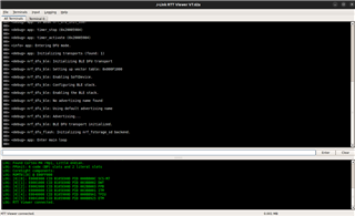

    Strange. I really thought it had to be the GCC version. I have not managed to reproduce the problem here either, unfortunately. Here is what I did in my attempt to reproduce it on my end:
    1. Connected a nRF52840 DK to the PC
    2. Changed toolchain path from GCC ARM Embedded 9.2020-q2.major to gcc-arm-none-eabi-10.3-2021.10 in /nRF5_SDK_17.1.0_ddde560/components/toolchain/gcc/Makefile.posix
    3. Opened the terminal in /nRF5_SDK_17.1.0_ddde560/examples/dfu/secure_bootloader/pca10056_s140_ble_debug/armgcc
    4. Ran 'make flash_softdevice && make flash' to program the board. Note: these makefile targets do use nrfjprog
    5. Observed that the board was advertising as "DFUTarg"
    Log output after running 'make flash_softdevice && make flash'
    Do you notice any differences in my approach above compared to yours?
