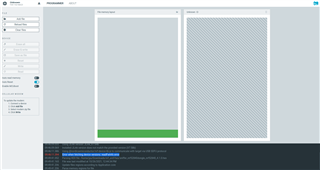

I have just received nRF52840 dongle and I cannot get it programed. I have tried both west flash and nrfProgrammer from nrfConnect.
I have been developing using nrf52840dk so far, and I have no issue programming the dk.
In nrfProgrammer device comes as Unknown ( shown on attached nrf52840.png) I am attaching the log in a separate file  nrfProgrammer.log
Syslog output from Ubuntu 20.04:

Do you have any suggestion on how can I program the dongle?
Please let me know if you need any other information.
  • Red LED is blinking after plugging the dongle  into the PC USB port.
    I have also tried multiple USB ports on the PC.

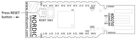

    The nRF52840 Dongle does not have an onboard debugger, so you cannot program it using west unless you are using an external debug probe. Instead, you can put it in bootloader mode and use the Programmer app or nrfutil to upload the new firmware to it. To make the dongle enter bootloader mode you need to press the RESET button:
    If the dongle is already plugged in when you press the RESET button it might not go into bootloader mode, so please try to unplug the dongle from your computer, and then hold in the RESET button while you plug it in. It should show up in the Programmer app as a bootloader device.

  • Thanks for the reply.
    I was pressing the RESET button and the LED2 was flashing red indicating bootloader mode. Syslog on ubuntu was also indicating bootloader mode:
    May 23 09:32:33 jyu-ThinkPad-T470p kernel: [ 4146.453946] usb 1-2: New USB device strings: Mfr=1, Product=2, SerialNumber=3
    May 23 09:32:33 jyu-ThinkPad-T470p kernel: [ 4146.453951] usb 1-2: Product: Open DFU Bootloader
    In the and I have managed to program it for the "nRF Sniffer for Bluetooth LE"  from Windows on the same PC(using exactly the same steps) in the end. Apparently there was an issue with the Ubuntu 20.04 environment for the nrf52840dongle ( although it works fine with the nrf528400dk)
    Now when booting without pressing RESET device is recognized as "nRF Sniffer for Bluetooth LE" . When booting with RESET pressed LED blinks red and device is recognized as "Product: Open DFU Bootloader" but still the nrfProgrammer is unable to program the device:

    We need to be able to program the device from the Linux system. Any hints on resolving the programming issues on Ubuntu 20.04?
    It is good to hear that you are able to program it from Windows at least. I will check internally if there are any known issues with Ubuntu.
    Please gather a log of this issue in Ubuntu with verbose logging enabled:
    1. Make sure the dongle is plugged into the computer and in bootloader mode.
    2. Go to the 'about' tab in the Programmer app.
    3. Enable verbose logging and select 'restart with verbose logging'.
    4. After the Programmer restarts try to select the dongle from the device list.
    5. Select 'open log file' at the bottom of the terminal in the Programmer.
    6. Upload the log here.
    I will forward the log to the developers.
    Marte
  • Thanks again for the fast reply. I am attaching the log file.

    2022-05-24T06:40:31.491Z DEBUG App pc-nrfconnect-programmer v3.0.0 official
    2022-05-24T06:40:31.491Z DEBUG App path: /home/jyu/.nrfconnect-apps/node_modules/pc-nrfconnect-programmer
    2022-05-24T06:40:31.491Z DEBUG nRFConnect 3.11.0, required by the app is (^3.10.0)
    2022-05-24T06:40:31.491Z DEBUG nRFConnect path: /tmp/.mount_nrfconb8PuM0/resources/app.asar
    2022-05-24T06:40:31.491Z DEBUG HomeDir: /home/jyu
    2022-05-24T06:40:31.491Z DEBUG TmpDir: /tmp
    2022-05-24T06:40:31.494Z INFO Installed JLink version does not match the provided version (V7.58b)
    2022-05-24T06:40:31.495Z WARN [nrfdl][warning](08:40:31.491) JlinkArm version non expected one found: JLink_V7.64b, expected: JLink_V7.58b
    2022-05-24T06:41:26.623Z DEBUG Sending usage data...
    2022-05-24T06:41:26.623Z DEBUG Category: pc-nrfconnect-programmer
    2022-05-24T06:41:26.623Z DEBUG Action: Open device
    2022-05-24T06:41:26.623Z DEBUG Label: nordicUsb
    2022-05-24T06:41:26.625Z DEBUG Usage data has been sent
    2022-05-24T06:41:26.629Z INFO Using @nordicsemiconductor/nrf-device-lib-js to communicate with target via USB SDFU protocol
    2022-05-24T06:41:26.629Z DEBUG Sending usage data...
    2022-05-24T06:41:26.629Z DEBUG Category: pc-nrfconnect-programmer
    2022-05-24T06:41:26.629Z DEBUG Action: Open jlink device family
    2022-05-24T06:41:26.629Z DEBUG Label: nRF52
    2022-05-24T06:41:26.630Z DEBUG Usage data has been sent
    2022-05-24T06:41:26.630Z DEBUG Sending usage data...
    2022-05-24T06:41:26.631Z DEBUG Category: pc-nrfconnect-programmer
    2022-05-24T06:41:26.631Z DEBUG Action: Open jlink device version
    2022-05-24T06:41:26.631Z DEBUG Label: nRF52840
    2022-05-24T06:41:26.631Z DEBUG Usage data has been sent
    2022-05-24T06:41:26.632Z DEBUG Sending usage data...
    2022-05-24T06:41:26.632Z DEBUG Category: pc-nrfconnect-programmer
    2022-05-24T06:41:26.632Z DEBUG Action: Open jlink device board version
    2022-05-24T06:41:26.632Z DEBUG Label: PCA10059
    2022-05-24T06:41:26.633Z DEBUG Usage data has been sent
    2022-05-24T06:41:26.637Z ERROR Error when fetching device versions: readFwInfo error
    2022-05-24T06:41:26.640Z VERBOSE [nrfdl][trace](08:41:26.633) DeviceLister::enumerate: Checking future_status of enumerate_task_status
    2022-05-24T06:41:26.640Z VERBOSE [nrfdl][trace](08:41:26.633) Matching device traits and firmware: firmware_format:not set matches:[trait:false firmware:true]
    2022-05-24T06:41:26.641Z VERBOSE [nrfdl][trace](08:41:26.633) Matching device traits and firmware: firmware_format:not set matches:[trait:false firmware:true]
    2022-05-24T06:41:26.642Z VERBOSE [nrfdl][trace](08:41:26.633) Matching device traits and firmware: firmware_format:not set matches:[trait:false firmware:true]
    2022-05-24T06:41:26.643Z VERBOSE [nrfdl][trace](08:41:26.633) Matching device traits and firmware: firmware_format:not set matches:[trait:false firmware:true]
    2022-05-24T06:41:26.644Z VERBOSE [nrfdl][trace](08:41:26.633) Matching device traits and firmware: firmware_format:not set matches:[trait:false firmware:true]
    2022-05-24T06:41:26.645Z VERBOSE [nrfdl][trace](08:41:26.633) Matching device traits and firmware: firmware_format:not set matches:[trait:false firmware:true]
    2022-05-24T06:41:26.645Z VERBOSE [nrfdl][trace](08:41:26.633) DeviceLister::enumerate: Waiting for enumerate task to complete
    2022-05-24T06:41:26.646Z VERBOSE [nrfdl][trace](08:41:26.633) DeviceLister::enumerate::enumerate_task: Start
    2022-05-24T06:41:26.647Z VERBOSE [nrfdl][trace](08:41:26.633) DeviceLister::enumerate: Found device with serial number: F3E11021BA23
    2022-05-24T06:41:26.647Z VERBOSE [nrfdl][trace](08:41:26.633) DeviceLister::enumerate: device registered to device list
    2022-05-24T06:41:26.648Z VERBOSE [nrfdl][trace](08:41:26.633) DeviceLister::enumerate: Found device with serial number: 543e8c5754f9
    2022-05-24T06:41:26.649Z VERBOSE [nrfdl][trace](08:41:26.633) DeviceLister::enumerate: Completed waiting for enumerate task
    2022-05-24T06:41:26.649Z VERBOSE [nrfdl][trace](08:41:26.633) DeviceLister::enumerate: done
    2022-05-24T06:41:26.650Z ERROR [nrfdl][error](08:41:26.633)  NRFDLException(200): no matching trait found
    I have my user added to the dialout group (owner of /dev/ttyACM0). I have also tried changing the permissions of the /dev/ttyACM0 to 0666 ( same as the developmentKit when it  comes up) and I still experience the same error.
    When the dongle is started in a normal mode ( as a sniffer), the dongle is opened, and used by Wireshark without any issues.
    Let me know if you need any other info.
