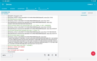

I have a custom board with nRF52840/SDK 16/Softdevice 7.3.0 using Secure Dfu Bootloader. On my Android device I use Nordic Dfu Library. I have tried all available Dfu lib versions from 1.11.0 to 2.0.2.
I've had Dfu up and running for a few months and it has been working fine for most Android devices I have tested so far. However I just recently bought a Samsung Galaxy Tab A8/Android 11 and the Dfu does not work on this device returning the error 'Unable to write Op Code 3 (error 133)'. Below I will show logs from Android Studio logcat and also from my Peripheral custom board for case 1 (Samsung Galaxy Tab A8/Android 11 ) where Dfu fails and case 2 (Samsung Galaxy S20 FE/Android 12) where Dfu succeeds. I also provide the relevant app code section I use for Dfu. In the app code I have tried different settings, for example setting the PRN value to 1 and increasing the 'preparDataObjectDelay' up to 400.
I am grateful for any tip.

2022-05-23 13:38:25.138 25812-27662/com.prisma.ui I/DfuImpl: Sending Calculate Checksum command (Op Code = 3)
2022-05-23 13:38:31.124 25812-27285/com.prisma.ui E/DfuImpl: Characteristic write error: 133
2022-05-23 13:38:31.125 25812-27285/com.prisma.ui D/BluetoothGatt: onClientConnectionState() - status=8 clientIf=10 device=C6:5D:74:1E:7D:29
2022-05-23 13:38:31.128 25812-27662/com.prisma.ui E/DfuBaseService: Unable to write Op Code 3 (error 133)

    I notice that there is a lot of retransmissions in the failing trace. Do you by any chance have a log from the nRF side in this case (using the debug bootloader with RTT logging)?
    Other than that nothing sticks out, but I have asked our mobile developers to take a look.
    Edit: Does it always fail on the failing devices, or just from time to time?
    Great, now dfu works on my Samsung Tab A8. I made the workaround on SDK16.
    I will try dfu on the Nokia T20 Tablet after the weekend.
    Time for Dfu increased with 20% roughly.
    This will work as a short time solution.

    Regarding the required SDK modification, maybe this should be a setting in sdk_config.h to assign values to max_rx_octets/max_tx_octets used by ../components/libraries/bootloader/ble_dfu/nrf_dfu_ble.c?
    Otherwise one needs to remember to do this patch every time when switching to a new SDK version.
  • Roland B said:
    My Nokia T20 Tablet also works now with your suggested workaround.
    That makes sense, but it is good to get it confirmed.
    Good point. However, the problem is that the bootloader implementation does not use the sdk_config.h for this (I cannot say why, most likely historic reasons). And the nRF5 SDK is now in maintenance mode (see nRF Connect SDK and nRF5 SDK statement) so I do not expect this will ever change.
    Also note that here we are just working around an issue in the peer device, and we do not fully know why it misbehaved or how/why this workaround works. As we effectively prevent long packets it is highly likely that it will be a effective workaround going forward, though. But to be 100% confident, this needs to be fixed in the Android devices.
