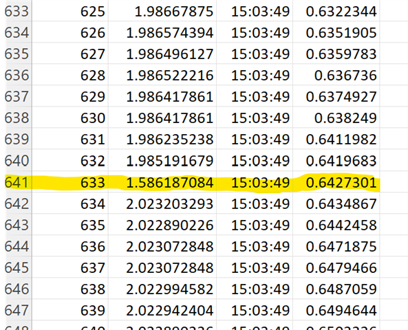

Dip on VDD line
The datasheet of nRF52810 says that, if the voltage drops below the operating voltage, the device shall undergo a brownout reset itself and it is supposed to work normally. But we are facing an issue that, when the voltage on VDD drops, the device works weird after that point.
The below given snapshot is the output from the digital multi-meter, and you can see a dip (1.58V, marked yellow). Does not the device reset itself in the below given case ? Why would the device behave abnormally after the dip ?
