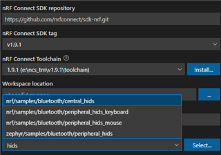

  • After looking at my list of options I do not get "peripheral_hids" but I do get keyboard which I will try.  Is this list filtered based on the target CPU?
    No, it does not filter based on target CPU. If you start writing "hids" in the application template field you should get all the samples shown in 's picture:
    The reason you do not find peripheral_hids is probably because you are looking for samples under nrf/samples, while peripheral_hids is a Zephyr sample, so it is located under zephyr/samples.
    From your description the Peripheral HIDS keyboard sample is probably the best place to start. You want the remote control to be a peripheral. Additionally, for controlling audio you can use the HID profile with multimedia keys, sort of as a keyboard device:
