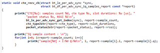

    But now i had another question because i have the impression that my program doesn't receive the IQ data for all the antenne. Can you help my on that too ?
    Here is the modified fonction in the main to print IQ data :
    Here is what my nrf52833 receive:
  • To me it looks like you have all the 45 samples you should have. What makes you think that you don't get all the IQ data?
    I would also like to add that the IQ data itself isn't very useful. You also need an (antenna specific) direction finding algorithm to convert the IQ data into a vector form.
    Nordic will not provide the direction finding algorithm, and customers/users are expected to get that elsewhere. In order to use the IQ data you get from the beacon you will need an AOA algorithm, which we don't provide. There is no point in looking at the raw data as it needs to be converted into vector form to review it properly. You can check out this page for information on the various formulas used to translate IQ data between polar and rectangular form.
  • The data are wrong because i disconnect my antenna number 3 (my antenna array have 4 antenna) and when i look at the IQ data i don't see any 0 or very very low values for IQ
  • Even though one of the antennas are disconnected, you will still get a sample from it (assuming that you sample it), and it is not given that you will get low values.
    I cannot see anything obviously wrong from the screenshots you have attached, but as I said in my previous reply, you must figure out most of the SW yourself.
