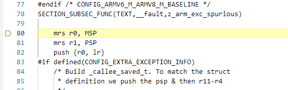

    Strange. I have staerted over, and the first time I debug the build configuration that has "Enable debug options" checked, it works fine. But all other debug sessions don't. I have attached three files with the printouts from "Debug console". One file is how it looks in the build configuration that doesn't have "Enable debug options" checked. The other two has the option checked. The one where debugging is working is the first debug session, the other one is how it looks for all other debug sessions. Is it possible to find any interesting information from this?
    Has any other of your team tested to see if you can repeat this?

    Reading symbols from c:/projekt\nordicsemi\v1.9.1\toolchain\opt\bin\arm-none-eabi-objdump.exe --syms -C -h -w c:\Projekt\nordic\aws_iot\build\zephyr\merged.hex
    Reading symbols from c:/projekt/nordicsemi\v1.9.1\toolchain\opt\bin\arm-none-eabi-nm.exe --defined-only -S -l -C -p c:\Projekt\nordic\aws_iot\build\zephyr\merged.hex
    Launching GDB: "c:\\Projekt\\NordicSemi\\v1.9.1\\toolchain\\opt\\bin\\arm-none-eabi-gdb.exe" -q --interpreter=mi2 "c:\\Projekt\\nordic\\aws_iot\\build\\zephyr\\merged.hex"
        Set "showDevDebugOutput": true in your "launch.json" to see verbose GDB transactions here. Helpful to debug issues or report problems
    Launching gdb-server: "C:\\Program Files (x86)\\SEGGER\\JLink\\JLinkGDBServerCL.exe" -singlerun -nogui -if swd -port 50000 -swoport 50001 -telnetport 50002 -device nRF9160_xxAA -select usb=960008799 -rtos "C:\\Program Files (x86)\\SEGGER\\JLink\\GDBServer\\RTOSPlugin_Zephyr.dll"
        Please check TERMINAL tab (gdb-server) for output from C:\Program Files (x86)\SEGGER\JLink\JLinkGDBServerCL.exe
    Finished reading symbols from objdump: Time: 96 ms
    Finished reading symbols from nm: Time: 95 ms
    Reading symbols from c:\Projekt\nordic\aws_iot\build\zephyr\merged.hex...
    (No debugging symbols found in c:\Projekt\nordic\aws_iot\build\zephyr\merged.hex)
    WARNING: Cortex-Debug will deprecate use of GDB version 8 after July 2022. Please upgrade to version 9+
    0x00025b22 in ?? ()
    Program stopped, probably due to a reset and/or halt issued by debugger
    add symbol table from file "c:/Projekt/nordic/aws_iot/build/zephyr/zephyr.elf"
    (y or n) [answered Y; input not from terminal]
    Reading symbols from c:/Projekt/nordic/aws_iot/build/zephyr/zephyr.elf...
    add symbol table from file "c:/Projekt/nordic/aws_iot/build/mcuboot/zephyr/zephyr.elf"
    Reading symbols from c:/Projekt/nordic/aws_iot/build/mcuboot/zephyr/zephyr.elf...
    add symbol table from file "c:/Projekt/nordic/aws_iot/build/spm/zephyr/zephyr.elf"
    Reading symbols from c:/Projekt/nordic/aws_iot/build/spm/zephyr/zephyr.elf...
    2
    Resetting target
    Temporary breakpoint 2, main () at C:/Projekt/NordicSemi/v1.9.1/modules/hal/nordic/nrfx/hal/nrf_wdt.h:427
    427	    p_reg->RR[rr_register] = NRF_WDT_RR_VALUE;
    Reading symbols from c:/projekt\nordicsemi\v1.9.1\toolchain\opt\bin\arm-none-eabi-objdump.exe --syms -C -h -w c:\Projekt\nordic\aws_iot\build_1_enable_debug_options\zephyr\merged.hex
    Reading symbols from c:/projekt/nordicsemi\v1.9.1\toolchain\opt\bin\arm-none-eabi-nm.exe --defined-only -S -l -C -p c:\Projekt\nordic\aws_iot\build_1_enable_debug_options\zephyr\merged.hex
    Launching GDB: "c:\\Projekt\\NordicSemi\\v1.9.1\\toolchain\\opt\\bin\\arm-none-eabi-gdb.exe" -q --interpreter=mi2 "c:\\Projekt\\nordic\\aws_iot\\build_1_enable_debug_options\\zephyr\\merged.hex"
    Finished reading symbols from objdump: Time: 89 ms
    Finished reading symbols from nm: Time: 92 ms
    Reading symbols from c:\Projekt\nordic\aws_iot\build_1_enable_debug_options\zephyr\merged.hex...
    (No debugging symbols found in c:\Projekt\nordic\aws_iot\build_1_enable_debug_options\zephyr\merged.hex)
    0x00000438 in ?? ()
    add symbol table from file "c:/Projekt/nordic/aws_iot/build_1_enable_debug_options/zephyr/zephyr.elf"
    Reading symbols from c:/Projekt/nordic/aws_iot/build_1_enable_debug_options/zephyr/zephyr.elf...
    add symbol table from file "c:/Projekt/nordic/aws_iot/build_1_enable_debug_options/mcuboot/zephyr/zephyr.elf"
    Reading symbols from c:/Projekt/nordic/aws_iot/build_1_enable_debug_options/mcuboot/zephyr/zephyr.elf...
    add symbol table from file "c:/Projekt/nordic/aws_iot/build_1_enable_debug_options/spm/zephyr/zephyr.elf"
    Reading symbols from c:/Projekt/nordic/aws_iot/build_1_enable_debug_options/spm/zephyr/zephyr.elf...
    2
    Resetting target
    [New Remote target]
    [Switching to Remote target]
    Thread 2 hit Temporary breakpoint 2, main () at C:/Projekt/NordicSemi/v1.9.1/modules/hal/nordic/nrfx/hal/nrf_wdt.h:427
    Finished reading symbols from objdump: Time: 81 ms
    Finished reading symbols from nm: Time: 85 ms
    0x00025b22 in ?? ()
    2
    Resetting target
    [New Thread 536930240]
    [New Thread 536923376]
    [New Thread 536925696]
    [Switching to Thread 536930240]
    Run to 'main' timed out. Trying to pause program

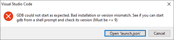

    Now I have installed SDK 2.0.0 and tested sample aws_iot. It is the same bahaviour as I experienced in my first post in this case (for SDK 1.9.1): a build configuration with "Enable debug options" checked doesn't work to debug, while not checking the "Enable debug options"-box will make it possible to debug.
    When I now run aws_iot sample with SDK 1.9.1, it worked as mentioned above before. But now I get this error (no matter if "Enable debug options" is checked or not):
    cortexm-debug extension message: 'WARNING: Cortex-Debug will deprecate use of GDB version 8. Please upgrade to version 9+'
    How come somethng that worked before doesn't work now? I thought that using a specific SDK with a specific toolchain would always do the same thing.
    I have found this post: devzone.nordicsemi.com/.../cortexm-debug-extension-message-warning-cortex-debug-will-deprecate-use-of-gdb-version-8-please-upgrade-to-version-9. I seems to describe how to do a manual installation. I have only installed through nRF Connect for Desktop. Reading this page makes me only confused. Do I need to do something manually, or can I go through some GUI?

  • Hi again,
    The above support info-files are for aws_iot from SDK 2.0.0.
    Here I attach support info for aws_iot SDK 1.9.1, where I get the message
    "WARNING: Cortex-Debug has deprecated use of GDB version 8 after July 2022. Please upgrade to version 9+"
    How come something that worked before doesn't work now? I thought that using a specific SDK with a specific toolchain would always do the same thing.
    Lars

    To try to come back to the previous state where debugging in some way worked, I have now uninstalled V2.0.0. But if I then try to debug aws_iot v1.9.1 I get this error message:
    Just flashing aws_iot 1.9.1 works fine, it connects and runs as it should.
    Reinstalling V2.0.0 I still get this error message for aws_iot v1.9.1. And, running aws_iot 2.0.0 I also get that error message.
    Lars
