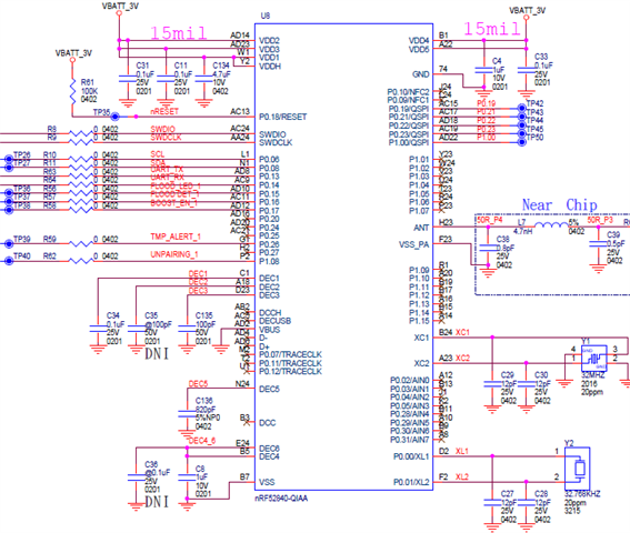

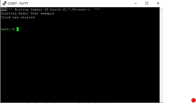

It works very well on 52840dk, but it doesn't work on my own board. But I found that when I erase all, there will be uart data as shown in the picture below, do you have any ideas?
