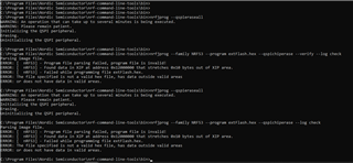

I am working on to flash my firmware binary into external flash by using nrfjprog commandline tools.
I have used below command to program and verify the external flash programming.
1) nrfjprog --family NRF53 --program zephyr.hex --qspichiperase --log abc.log
2) nrfjprog --family NRF53 --verify zephyr.hex --log abc.log
But it gives below error, can anyone tell me what command should I have to use to program the external flash?
    Command qspieraseall can be used for erasing external flash.
    nrfjprog --qspieraseall
    Afterwards, you can proceed to programming the application. When programming, you could try adding --verify to the first line, like this
    nrfjprog --family NRF53 --program zephyr.hex --qspichiperase --verify
    After you erased external flash, you could also specify the core you want to use when programming
    nrfjprog --family NRF53 --coprocessor CP_APPLICATION --program zephyr.hex --qspisectorerase --verify
    Please let me know the results of the above-mentioned approaches.
    Dejan
  • nrfjprog --qspieraseall
    The above command works for me now, I am not sure why it was not working previously, I had change nothing in my system.
