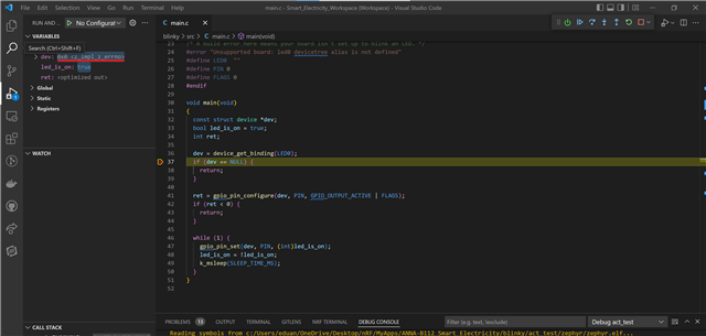

device_get_binding returning NULL for a custom board (blinky example)
I created a simple custom board (in VS Code 'Create a new board' Wizard) based on nrf9160 secure.
I copied the LED part of the original dts and I want to run blinky.
At first it worked, then somehow somewhere it stopped working. I traced the issue down to the function device_get_binding() that keeps returning NULL for my custom board even though all applicable settings and pins are identical.
I have tried the same with nrf52840 and nrf52832 and I get the same result.
The frustrating part is that it did work and stopped working all of a sudden - Is there some global setting that I could have accidently changed?
  • Hello Eduan, can you share the device tree you are using and show the definition of LED0 ?
  • Hi, this is the dts file for the nrf52832 example:

  • Here is my main.c:

    void main(void)
    	const struct device *dev;
    	bool led_is_on = true;
    	int ret;
    	dev = device_get_binding(LED0);
    	if (dev == NULL) {
    		return;
    	ret = gpio_pin_configure(dev, PIN, GPIO_OUTPUT_ACTIVE | FLAGS);
    	if (ret < 0) {
    		return;
    	while (1) {
    		gpio_pin_set(dev, PIN, (int)led_is_on);
    		led_is_on = !led_is_on;
    		k_msleep(SLEEP_TIME_MS);
  • Can you try with:
    #define C_LED_LABEL DT_GPIO_LABEL(LED0_NODE, gpios)
    device_get_binding(C_LED_LABEL);
  • Nope, same issue. How can something as simple as this not work? This is really frustrating
