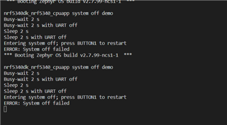

Hi Jorgen,
I have tested that sample with nrf5340dk. I have got the sleep mode failed error.
Kindly, help me to rectify this
Thanks & Regards,
Navin
The error is typically shown if the application is not able to enter System OFF mode, as the call to enter System OFF should not return, and a wakeup will trigger a reset. The reason for this may be that the chip is in debug interface mode, which will make the chip enter Emulated System OFF mode.
Please make sure to power cycle the device/board before testing the sample, to make sure it is not in debug interface mode.
I ensure that the device is not in debug interface mode. Still, the error is coming
Thanks & Regards,
NAVIN
You should not get this error if you are not in debug interface mode/emulated system off. Did you disconnect the debugger? Are you logging over UART or RTT? If using RTT, you should disconnect the RTT terminal to prevent debug mode.
Did you make any modifications to the example? Witch version of nRF Connect SDK are you using?
