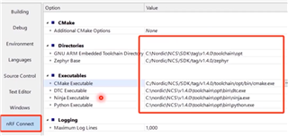

core_cm33.h: No such file or directory i find this question in your net address but It doesn't seem to have been resolved
i  install  F:\nrf-command-line-tools    、 nRF Connect for Desktop 、 toolchain manager v0.10.3、    finally install  "nrf connect SDK v1.91" in   F:/ncs
and  Follow a video tutorial to do the following "executables" setting
 and  get the  title's  trouble    ,if i not do this  i can't creat project
  • Help the poor child   , if  you not meet trouble ,can i see your every tools install folder path  ?  should i download the latest SEGGER IDE  separately?  and the vsc also can't creat project

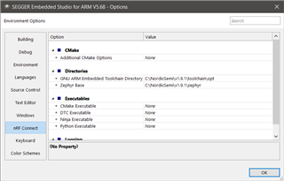

    I'm very confused. What exactly are you trying to achieve? What video are you referring to? When using the Toolchain Manager, you should install the SDK to a short path e.g. C.\NCS\v1.9.1.
    Is F:\ on you computer a network drive?
    What exactly is the issue you are having trouble with?
    After installing nRF Connect SDK v1.9.1 using the Toolchain Manager, you should be able to open the Segger Embedded Studio from Toochain Manager. This will provide correct paths for nRF Connect in Options i.e.
    From here it should build projects without issues. Are you getting any errors?
