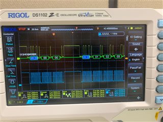

I am developing a driver for the vl53l5cx TOF sensor from ST, however their sequential write format looks as such:
This is problematic for me since I can get the address, and register index sent correctly with the stop bit at the end, however zephyr always sends a start bit for the data being written and I have not found a way to disable this. How can I do this using sdk 1.9.1?

  • Aha, turns out that is exactly what I have done. But it still gives me a start bit before the data bytes. I removed the I2C_MSG_WRITE from the second message but still no luck.
    See here:
    Using:
    static inline int i2c_write_test(const struct device *dev, uint8_t *write_reg, uint8_t *write_buf, size_t num_write, uint16_t addr)
    	struct i2c_msg msg[2];
    	msg[0].buf = write_reg;
    	msg[0].len = 2U;
    	msg[0].flags = I2C_MSG_WRITE | I2C_MSG_STOP;
    	msg[1].buf = write_buf;
    	msg[1].len = num_write;
    	msg[1].flags = I2C_MSG_STOP;
    	return i2c_transfer(dev, msg, 2, addr);

  • That's what I thought as well, it's strange that they wrote it in such a way. Perhaps it is an issue with the datasheet, I will contact ST about this. I will keep playing around with different variations to see what works. But yes it mentions here:
    That P is for stop and S is for start.
