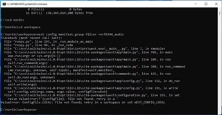

    I did the Windows 11 installation which appears to have gone ok with no errors generated (I'll raise a separate ticket if I encounter any). I found that whether I used the Windows Command Prompt or Bash (both launched from SDK Connect SDK v2.0.0) and navigate to my workspace folder and execute west config manifest.group-filter +nrf5340_audio I find that a series of instructions are executed, but fails due to CongfigFile.LOCAL not being found and that I need to set WEST_CONFIG_LOCAL.
    How do I do this please?

    I then open a new terminal window from nRF Connect SDK and execute the west config and west update instructions there, whilst everything appears to execute ok, I still can't see any project files (see also private ticket for same issues on Windows installation):
    Last login: Wed Jun  8 15:15:57 on ttys000
    The default interactive shell is now zsh.
    To update your account to use zsh, please run `chsh -s /bin/zsh`.
    For more details, please visit https://support.apple.com/kb/HT208050.
    export PATH=/opt/nordic/ncs/toolchains/v2.0.0/bin:/opt/nordic/ncs/toolchains/v2.0.0/usr/bin:/opt/nordic/ncs/toolchains/v2.0.0/usr/local/bin:/opt/nordic/ncs/toolchains/v2.0.0/opt/bin:/opt/nordic/ncs/toolchains/v2.0.0/opt/nanopb/generator-bin:/opt/nordic/ncs/toolchains/v2.0.0/opt/zephyr-sdk/arm-zephyr-eabi/bin:$PATH
    export GIT_EXEC_PATH=/opt/nordic/ncs/toolchains/v2.0.0/Cellar/git/2.32.0_1/libexec/git-core
    export GIT_TEMPLATE_DIR=/opt/nordic/ncs/toolchains/v2.0.0/Cellar/git/2.32.0_1/share/git-core/templates
    export ZEPHYR_SDK_INSTALL_DIR=/opt/nordic/ncs/toolchains/v2.0.0/opt/zephyr-sdk
                    cd /opt/nordic/ncs/v2.0.0
                    clear
    COMPUTER:~ XXXXXXXX$ export PATH=/opt/nordic/ncs/toolchains/v2.0.0/bin:/opt/nordic/ncs/toolchains/v2.0.0/usr/bin:/opt/nordic/ncs/toolchains/v2.0.0/usr/local/bin:/opt/nordic/ncs/toolchains/v2.0.0/opt/bin:/opt/nordic/ncs/toolchains/v2.0.0/opt/nanopb/generator-bin:/opt/nordic/ncs/toolchains/v2.0.0/opt/zephyr-sdk/arm-zephyr-eabi/bin:$PATH
    COMPUTER:~ XXXXXXXX$ export GIT_EXEC_PATH=/opt/nordic/ncs/toolchains/v2.0.0/Cellar/git/2.32.0_1/libexec/git-core
    COMPUTER:~ XXXXXXXX$ export GIT_TEMPLATE_DIR=/opt/nordic/ncs/toolchains/v2.0.0/Cellar/git/2.32.0_1/share/git-core/templates
    COMPUTER:~ XXXXXXXX$ export ZEPHYR_SDK_INSTALL_DIR=/opt/nordic/ncs/toolchains/v2.0.0/opt/zephyr-sdk
    COMPUTER:~ XXXXXXXX$                 cd /opt/nordic/ncs/v2.0.0
    COMPUTER:v2.0.0 XXXXXXXX$                 clear
    COMPUTER:v2.0.0 XXXXXXXX$ west config manifest.group-filter +nrf5340_audio
