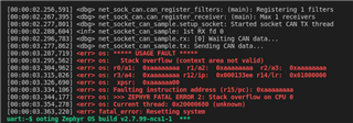

I am trying to use the MCP2515 SPI2CAN adapter with the nRF9160 DK.
I started by trying to get the Zephyr socket_can sample to work. My efforts are based on this thread.
The problem is, that I am always getting an "SPI bus not ready" error from the can_mcp2515 driver.
I successfully tested the SPI with a simple loopback example, so the overlay should be correct.
Here is my device tree overlay:

Output:
  • yavordobrev said:
    Could it be that the mcp2515 driver is trying to use spi before it is actually initialized?
    Yes, that appears to be the case. If I run the sample as a secure target (nrf9160dk_nrf9160), the output looks a little bit different.

    [00:00:06.420,379] <dbg> mcp2515_can.socket_can_send: Cannot send socket CAN msg (-11)
    Can you test this as well and confirm that it works?
    In that case: I assume this is a timing issue with the Secure Partition Manager.
