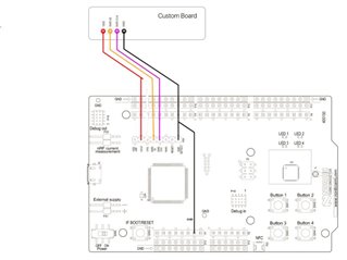

Flashing and debugging an external nrf52840 board with the nRF52840 DK different to those covered in forum
I have read the other threads regarding this, but doesn't appear to work.
I have noticed on my nRF52840 DK that P20 has a different pinout
So I have tried an assortment of connections to this board to the SWDIO,SWDCLK,SWO and VDD.
I am unsure whether the idea is to ground my board to the dev board seperately and wire the GND of my connector to the SELECT pin.
No matter what I do the Programmer tools always sees the onboard device.
I close and reopen the programmer each time, as I don't know if it auto-updates dynamically.
