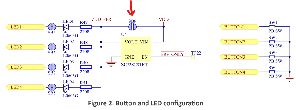

I have a nRF52840 DK board. Which I bought about 1.5 years ago. I used to do some development using Segger Embedded Studio those days.
Now I have setup the Zephyr Project in the Visual Studio environment. I started with the Blinky project. I built it and flashed it to the board.
However, the LED1 did not start blinking.
I noticed that when I short the bridge SB9, the LED1 starts to blink.
I am not sure whether there is an issue with my project configuration or some hardware issue.
Hope anyone can help me with this.
Thanks a lot!!
