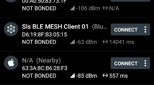

I am using nRF52833 DK and I am running Light switch server in one DK and Client in another DK
Advertising interval was way too high(around 9Second)
so decided to change it.
Defined a interval of 50ms and under mesh_adv.c file, have defined this MACRO and changed duration and interval parameters.
#define CUSTOM_ADV_INTERVAL MSEC_TO_UNITS(50, UNIT_0_625_MS)
m_adv_params.duration = 0;
m_adv_params.interval = CUSTOM_ADV_INTERVAL;
Now the Advertising interval have been reduced, but it keeps on fluctuating
I am using nRF connect App to check the ADV interval timer, for some time it scans at 20ms and for some time scans at 100ms
I expect that to be around 50ms(+ or - 50ms) constantly.
Is this behavior expected ?
Is this fluctuating is normal ?
Any feedback would be helpful
Thanks in Advance.
Sarjoon.

    >> Didn't measure any interval. Just once after started the light switch applications on DK board, I expect the Node to get scanned quickly. But its taking so much for its to appear in nRF connect App. Almost more than 30 seconds. I need to keep scanning it.
    Attaching the timer Image for reference.
    See the image.
    Sls BLE MESH is our custom Client which runs Light switch client application.
    Tat shows almost 14Sec interval(14041ms)
    This is what I meant like its taking lot of time to scan it.

    Both 30 seconds and 14 seconds sounds way too high. It is hard to tell, however, why it takes so long in this particular situation.
    For instance, do you have other connections running on the smartphone, and/or is the smartphone connected to a WiFi network at the same time? This can reduce the time used for scanning on the smartphone. It is also possible to be unlucky with advertising and scan timings.
    To figure out what happens in this case, a sniffer trace would be very useful, as it would reveal the actual advertisement timings from the mesh device.
