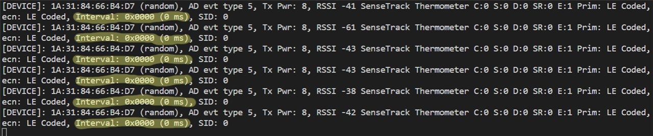

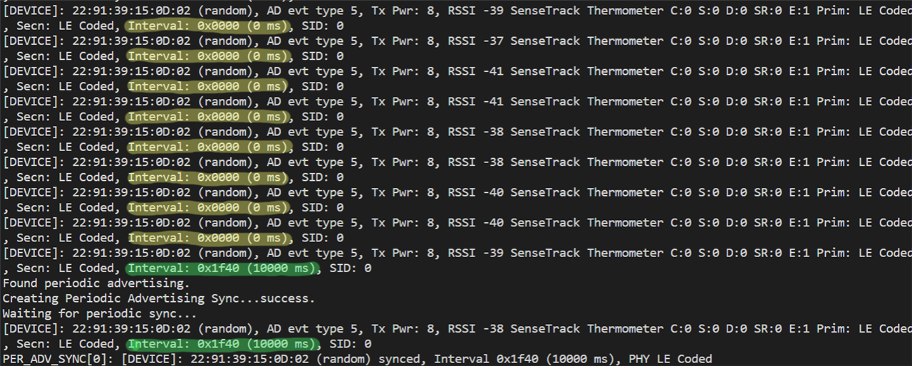

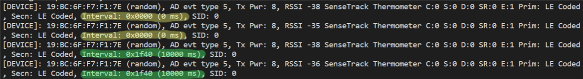

Here are some screenshots showing the terminal on the receiver when the Periodic Interval was set to 10s and the Advertising Interval was varied between 3s, 5s, and 10s.
3 second advertising interval:
5 second advertising interval:
10 second advertising interval:
