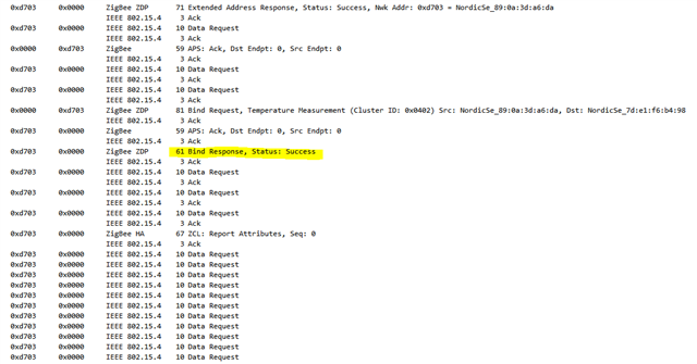

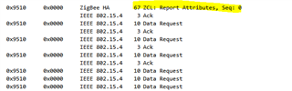

1)  The "ep_handler_report" is not called, but I see in Wireshark that a Report Attributes has been sent?
Is there still something to change at the sensor, because there I have left everything as is.

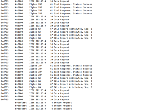

2) After a while the network crashes, any idea what this is? The Connected LED on the sensor goes out.
    Make sure to register the device context before registering the endpoint handler. For example:
    ZB_AF_REGISTER_DEVICE_CTX(&device_ctx);
    ZB_AF_SET_ENDPOINT_HANDLER(DEVICE_ENDPOINT, ep_handler_report);
    Also make sure you are using the correct endpoint. From your ZB_AF_SET_ENDPOINT_HANDLER it seems like you might be using the light switch example, since you are using m_device_ctx.bulb_params.endpoint. If that is the case, then the endpoint given by m_device_ctx.bulb_params.endpoint is the endpoint of the light bulb. The endpoint handler you register with ZB_AF_SET_ENDPOINT_HANDLER will handle ZCL packets incoming on the endpoint you use when you register it, so this endpoint must be an endpoint registered on the device, and it must be the same endpoint as used for the device context. So for the light switch you would have:
    A beacon request is sent by a device wanting to join a network as a part of scanning for networks. Devices can do passive or active scans. In the case of active scans the device will send out a beacon request to try to discover networks on the channel. If there is a network, then nearby routers will send a beacon in response.
    Do you have any indication as to why the network crashes? If you upload a sniffer log of the issue as a pcap I can look at it and see if I can find what the issue might be.

    Because of the network crash, I have tested again. This only occurs after the binding request with the "ZB_ZCL_CLUSTER_ID_TEMP_MEASUREMENT". Attached, I send you the sniffer data and the code that performs the binding. Maybe you will find a problem. The funny thing is that the sensor responds to the binding request, with Success, but after that the callback function is not called Disappointed (Look down below in the image sniffer data (marked yellow)).
    Still attached is my bind function as well as the corresponding callback function, maybe this helps you a bit. The long addresses are passed correctly after own checks (NRF_LOG_INFO...).

    Sniffer Data:
    If I do not call the "bind_device" function, the sensor remains connected in the network. This means that it should be the "bind_device" function that is the problem.
    From your sniffer log and what you say about the bind callback not being called it seems like the coordinator stops working either right after sending the bind request or immediately when it receives the response but before it is able go into the callback function. The issue might be related to your coordinator endpoint, since you are creating a binding on an endpoint that is reserved and should not be used in the application. You should change COORDINATOR_ENDPOINT to something else and see if that fixes the issue. Other than that I do not see any obvious issues with your bind request and callback. If you are still seing the problem after changing the endpoint value you can upload your project here and I can test it on my side.

    Thank you very much for response. I did the coordinator number wrong and have now changed it. Thank you for the advice. Slight smile However, unfortunately, the error can not be fixed Hushed. I also copied the main and loaded into a new ZigBee light example (light_coordinator [ZigBee_3_2\examples\zigbee\light_control\light_coordinator"). But again the same error came out. Slight frown
    The aim of the project is to read out the multi sensor with a coordinator and to output it on the interface (e.g. uart, display...).
    But I'll try to get only the temperature values from the sensor, later the pressure will follow.
    I have now enclosed the entire project folder for you and will point out the locations. Additionally I have attached the Main File to them again.

    /**@brief The Handler to 'intercept' every frame coming to the endpoint
     * @param param[in]  Reference to a ZBOSS buffer
     * @returns ZB_TRUE if ZCL command was processed.
    static zb_uint8_t ep_handler_report(zb_uint8_t param)
        NRF_LOG_INFO("Ep Handler Report");
        zb_buf_t            *  p_zcl_cmd_buf = (zb_buf_t *)ZB_BUF_FROM_REF(param);
        zb_zcl_parsed_hdr_t *  p_cmd_info    = ZB_GET_BUF_PARAM(p_zcl_cmd_buf, zb_zcl_parsed_hdr_t);
        //tsn_ctx_t           *  p_tsn_ctx;
        if (p_cmd_info->cmd_id == ZB_ZCL_CMD_REPORT_ATTRIB)
            NRF_LOG_INFO("print_attr");
            print_attr(p_cmd_info, param);
            ZB_FREE_BUF_BY_REF(param);
            return ZB_TRUE;
        else if (p_cmd_info->cmd_id == ZB_ZCL_CMD_CONFIG_REPORT_RESP)
            // Find command context by ZCL sequence number.
            /*p_tsn_ctx = get_ctx_by_tsn(p_cmd_info->seq_number);
            if (p_tsn_ctx != NULL)
                NRF_LOG_WARNING("Unsubscribe cb");
                //cmd_zb_subscribe_unsubscribe_cb(p_tsn_ctx, param);
                return ZB_TRUE;
        NRF_LOG_INFO("False Handler report");
        return ZB_FALSE;

    /*@brief Step 4: Send a subscribe request
    static void subscribe_device(zb_uint8_t param)
        zb_buf_t                         * p_buf  = ZB_BUF_FROM_REF(param);
        configure_reporting_req_t          req;
        tsn_ctx_t                        * p_tsn_cli;
        zb_uint8_t                       * p_cmd_ptr;
        zb_ret_t                           zb_err_code;
        //zb_bool_t                          subscribe;
        zb_ieee_addr_t                     sensor_ieee_adr;
        NRF_LOG_INFO("----------------------------------------");
        NRF_LOG_INFO("Step 4: subscribe_device");
        req.profile_id   = ZB_AF_HA_PROFILE_ID;
        req.cluster_id   = ZB_ZCL_CLUSTER_ID_TEMP_MEASUREMENT;    //ZB_ZCL_CLUSTER_ID_PRESSURE_MEASUREMENT; //
        req.attr_id      = ZB_ZCL_ATTR_TEMP_MEASUREMENT_VALUE_ID;
        req.attr_type    = ZB_ZCL_ATTR_TYPE_16BIT;                //ZB_ZCL_ATTR_TYPE_S16;
        req.interval_min = ZIGBEE_CONFIGURE_REPORT_DEFAULT_MIN_INTERVAL;
        req.interval_max = ZIGBEE_CONFIGURE_REPORT_DEFAULT_MAX_INTERVAL;
        req.remote_node.addr_short = m_device_ctx.sensor_params.short_address;
        req.remote_addr_mode       = ZB_APS_ADDR_MODE_16_ENDP_PRESENT;      //= parse_address(addr_buf, &req.remote_node, ADDR_ANY);
        req.remote_ep              = m_device_ctx.sensor_params.endpoint;
        p_buf = ZB_GET_OUT_BUF();
        NRF_LOG_INFO("Configure Reporting");
        p_tsn_cli = get_free_tsn_ctx();
        if (!p_tsn_cli)
            NRF_LOG_ERROR("Too many configure reporting requests");
            ZB_FREE_BUF(p_buf);
            return;
        // Configure new tsn context.
        p_tsn_cli->taken = true;
        //p_tsn_cli->p_cli = p_cli;
        p_tsn_cli->tsn   = ZCL_CTX().seq_number;
        ZB_ZCL_GENERAL_INIT_CONFIGURE_REPORTING_SRV_REQ(p_buf,
                                                        p_cmd_ptr,
                                                        ZB_ZCL_ENABLE_DEFAULT_RESPONSE);
        ZB_ZCL_GENERAL_ADD_SEND_REPORT_CONFIGURE_REPORTING_REQ(p_cmd_ptr,
                                                               req.attr_id,
                                                               req.attr_type,
                                                               req.interval_min,
                                                               req.interval_max,
                                                               ZIGBEE_CONFIGURE_REPORT_DEFAULT_VALUE_CHANGE);
        ZB_ZCL_GENERAL_SEND_CONFIGURE_REPORTING_REQ(p_buf,
                                                    p_cmd_ptr,
                                                    req.remote_node,
                                                    req.remote_addr_mode,
                                                    req.remote_ep,
                                                    SENSOR_LOGGER_ENDPOINT, //CONTROLL_ENDPOINT
                                                    req.profile_id,
                                                    req.cluster_id,
                                                    NULL);
        NRF_LOG_INFO("Report sended Waiting for Values");
        //zb_err_code = ZB_SCHEDULE_ALARM(zb_subscribe_timeout, p_tsn_cli->tsn, ZIGBEE_CLI_CONFIGURE_REPORT_RESP_TIMEOUT * ZB_TIME_ONE_SECOND);
        if (zb_err_code != RET_OK)
            NRF_LOG_ERROR("Unable to schedule timeout timer");
            invalidate_ctx(p_tsn_cli);
        NRF_LOG_INFO("End");
     // ____    _      _             _
     //|__ /   | |__  (_)  _ _    __| |
     // |_ \   | '_ \ | | | ' \  / _` |
     //|___/   |_.__/ |_| |_||_| \__,_|
    /*@brief A callback function for binding
     * @param[in]  index of buffer
    static zb_void_t zb_bind_callback(zb_uint8_t param)
        NRF_LOG_INFO("Bind Callback");
        zb_zdo_bind_resp_t * p_resp = (zb_zdo_bind_resp_t *)ZB_BUF_BEGIN(p_buf);
        m_device_ctx.sensor_params.status = p_resp->status;
        if (m_device_ctx.sensor_params.status == ZB_ZDP_STATUS_SUCCESS)
            NRF_LOG_INFO("Step 7: Bind successfully on Target: 0x%04x, Endpoint: %d", m_device_ctx.sensor_params.short_address, m_device_ctx.sensor_params.endpoint);
            //subscribe_device(param);
        else
            NRF_LOG_WARNING("bind faild %d :(",p_resp->status);
    /*@brief Step 3: Function send a binding request
    static zb_void_t bind_device(zb_uint8_t param)
        zb_zdo_bind_req_param_t   * p_req;
        uint8_t			tsn;
        zb_ieee_addr_t              dst_ieee_addr;
        zb_osif_get_ieee_eui64(dst_ieee_addr);
        if (!p_buf)
            NRF_LOG_ERROR("failed to execute command (buf alloc failed)");
            return;
        p_req  = ZB_GET_BUF_PARAM(p_buf, zb_zdo_bind_req_param_t);
        NRF_LOG_INFO("Step 3: Try to bind");
        //ZB_MEMCPY(&p_req->src_address,           &m_device_ctx.sensor_params.long_address, sizeof(zb_ieee_addr_t));   //ieee address of sensor
        //ZB_MEMCPY(&p_req->dst_address.addr_long, &dst_ieee_addr,                          izeof(zb_ieee_addr_t));   //ieee address of coordinator
        //uint8_t var = 7; // Reverse assignment
        for (uint8_t i = 0; i < 8; i++)
            p_req->src_address[i] = m_device_ctx.sensor_params.long_address[i];   //ieee address of sensor
            p_req->dst_address.addr_long[i] = dst_ieee_addr[i];                   //ieee address of coordinator
            //var--;
        p_req->dst_addr_mode = /*ZB_APS_ADDR_MODE_64_ENDP_PRESENT;*/ ZB_BIND_DST_ADDR_MODE_64_BIT_EXTENDED;
        p_req->src_endp      = m_device_ctx.sensor_params.endpoint;               //endpoint of sensor
        p_req->dst_endp      = SENSOR_LOGGER_ENDPOINT;                            //endpoint of coordinator
        p_req->cluster_id    = ZB_ZCL_CLUSTER_ID_TEMP_MEASUREMENT;                //ZB_ZCL_CLUSTER_ID_PRESSURE_MEASUREMENT;
        p_req->req_dst_addr  = m_device_ctx.sensor_params.short_address;          //short address of sensor
        //Enclosed the data are output again
        NRF_LOG_INFO("Long address of Sensor");
            NRF_LOG_INFO("src_address:    %hx", p_req->src_address[i]);
        NRF_LOG_INFO("Long address of Coordinator");
            NRF_LOG_INFO("dst_address:    %hx", p_req->dst_address.addr_long[i]);
        NRF_LOG_INFO("dst_addr_mode:  %d", p_req->dst_addr_mode);
        NRF_LOG_INFO("src_endp:       %d", p_req->src_endp);
        NRF_LOG_INFO("dst_endp:       %d", p_req->dst_endp);
        NRF_LOG_INFO("cluster_id:     0x%04x", p_req->cluster_id);
        NRF_LOG_INFO("req_dst_addr:   0x%04x", p_req->req_dst_addr);
        tsn = zb_zdo_bind_req(ZB_REF_FROM_BUF(p_buf), zb_bind_callback);
        if (tsn == ZB_ZDO_INVALID_TSN)
            NRF_LOG_INFO("failed to send request, %d", tsn);
    	return;
        return;

  • Hi Jonas,
    Thanks for the detailed and clear explanation and code! Makes it much easier for us to debug projects and understand what is actually going on Slight smile
    I have started looking at your issue, and it seems to be buffer leak. The device gets a hard fault in zb_get_buf.
    When I commented out p_buf = ZB_GET_OUT_BUF(); in bind_device(), as well as the if statement for the buffer (lines 793-798), the device continued to run after the binding, and ran for about a minute before stopping. After also commenting out = ZB_BUF_FROM_REF(param); on line 677 in subscribe_device() so that the line was only zb_buf_t * p_buf; it ran for longer, about 4 minutes. All three times it crashed because of hard fault in zb_get_buf, and I suspect that is because it is not able to allocate a new buffer because they are all used. I have not had the chance to go through the entire project and find all possible problems yet, but I see that you are allocating a lot of buffers and scheduling alarms, so I would suggest starting by looking at this, so the places you use ZB_GET_OUT_BUF, ZB_BUF_FROM_REF, ZB_SCHEDULE_ALARM, etc.
    When the device was running it worked as expected, successfully creating a binding, receiving attribute reports and calling the endpoint handler, so that part works as it should until the hard fault.
    I will keep looking into the problem tomorrow.
