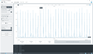

Our custom board using the nRF52840 with SDK 15.0.0 experiences a higher current draw if it starts up without the USBD module enabled at some time.  The first screenshot is when I power up and no USB is present, so USBD doesn't start up:

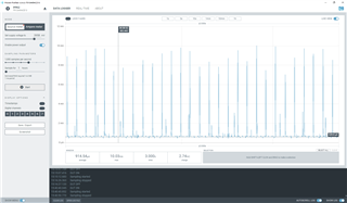

As you can see, there is a baseline current draw of around 600uA.  If I power up with USB attached and then remove USB after USBD has started, I get the following current draw:
This time the baseline current draw is less than 100uA.  I should note that I have to leave the USB in long enough to let the USBD start running, then I can remove the USB cable.  If I remove USB before it starts, it goes back to the current draw as when it powered up without USB.  If I comment out the USBD, it draws the high current even if I started it up with USB, so it appears to be a difference in something USBD does when it runs.  Shutting down USBD after it has started leaves that change in place.
