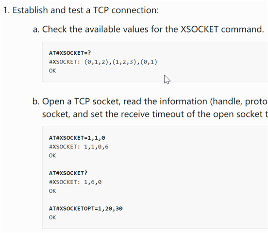

Hi, I test the TCP/IP AT command in 9160DK, I download the example Serial LTE modem,
I send the command as below picture.
but it reply as below

it seems My SIM card is OK, and signal is ok, but i can not connect to my DNS address. what's wrong?  need i configure somthing?
    AT#XCONNECT="runner.daigou52.cn",8282
    This domain does not exist when I tried to do a nslookup on it. Are you sure you've written the correct domain name?

    Does the CEREG notifications come after you have issued XCONNECT? If the order is correct here, then the "CEREG: 1, .." comes after you tried to connect, meaning that you haven't properly connected to the network at the time of trying to access the URL.

    If you connect using the IP directly, you are able to do so successfully?
    If that is successful, the issue is most likely that the network does not provide DNS. You can try to enable legacy PCO using this AT command:
    https://infocenter.nordicsemi.com/topic/ref_at_commands/REF/at_commands/packet_domain/xepco_set.html?cp=2_1_6_12_0
    ie:
    AT%XEPCO=0
    Note that this shall be issued before AT+CFUN=1.
