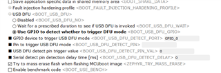

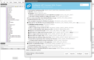

The MenuConfig page of SEGGER IDE (ncs1.9.1):
How should I configure this interface if I want to configure usb DFU and trigger upgrade mode via button: 1.boot_usb_dfu\Use gpio to detect whether to trigger dfu mode ,or   2.MCUBOOT_SERIAL\BOOT_SERIAL_DEVICE\BOOT_SERIAL_CDC_ACM  . Or check both of them. What's the difference between them? Because I think CDC ACM is a kind of USB. Do trigger GPIO need to be configured with the same pin?

  • Thank you very much for your help. As you can see, picture 1 in question contains USB DFU and picture 2 contains CDC ACM. I would like to know the difference between them, or I need to select both of them if I want to configure USB DFU.
