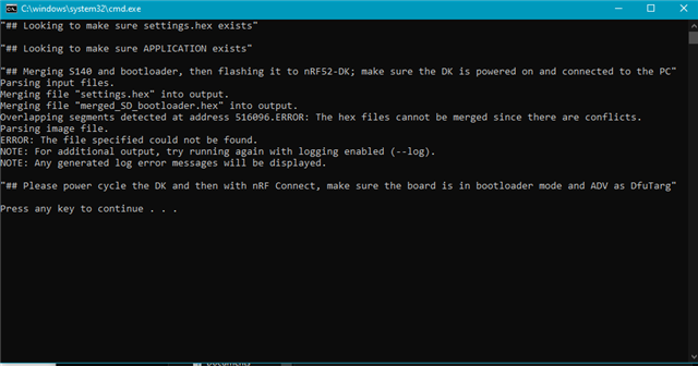

  • Hi Amanda,
                     I know its too late to reply but I have successfully manages to do OTA on NRF52833. Now my only issue is when for the first time I program the device, I am using merge hex to combine the softdevice,bootloader and application file. I give the following script  to generate merged hex file:-

    After running this script I load the generated merged hex file into device. Now what I have observed is the device stays in the bootloader mode. It does not automatically go into application mode.
    What changes are needed to do so that after flashing this merged hex file, the device will come out of bootloader mode and start running the application.
    If you flash that generated merged hex file into the device, you would also need to program the Bootloader settings page.
    -Amanda
  • So for NRF52833, this will be the command to generate settings file?
    nrfutil settings generate --family NRF52833 --application app.hex --application-version 3 --bootloader-version 2 --bl-settings-version 1 settings.hex
  • I actually tried to create settings using that command, settings was generated. but when I tried to merge it with my (sd+boodloader+application) hex file I am getting errors:
    The command used to generate settings is actually :-
    nrfutil settings generate --family NRF52 --application app.hex --application-version 1 --bootloader-version 2 --bl-settings-version 1 settings.hex
    guess some issue with version ??
