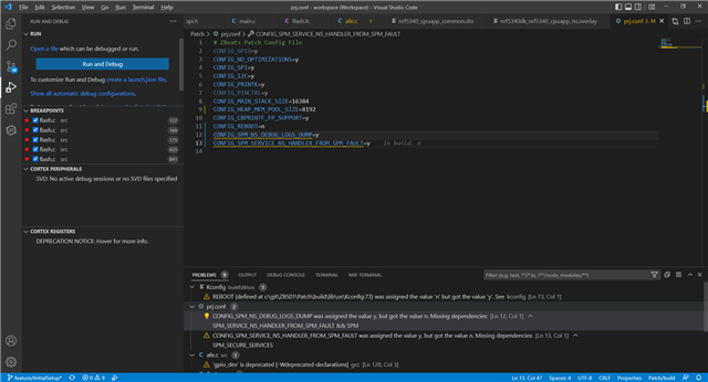

  • I stumbled across what caused this since no one was able to answer this.  And it's not enough stack specified in my prj.conf file.  Now my question is how do you know you have enough stack?  Is there a way to check usage?  Or just wait till you get stuck in the SPM and assume you need more?
  • Generally you can use the thread analyzer to check stack usage.
    http://developer.nordicsemi.com/nRF_Connect_SDK/doc/1.9.1/zephyr/guides/debug_tools/thread-analyzer.html#thread-analyzer
    Since this is SPM, you might also want to set:
    # When enabled, non-secure logs are printed to UARTE0 when secure fault occurs
    CONFIG_SPM_NS_DEBUG_LOGS_DUMP=y
    CONFIG_SPM_SERVICE_NS_HANDLER_FROM_SPM_FAULT=y
  • I wasn't able to get anywhere with that.  And the config items you listed come up with a problem.
    I don't think it's the SPM failing but my program failing and for some reason (which I can't figure out how to determine) the SPM just reboots and reboots.
    Are there any other ways to log or get information out somehow when your application crashes to help debugging?
