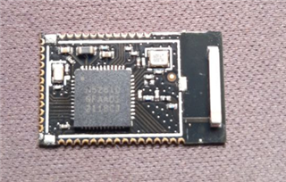

    I saw that you had created a second case right after replying to your previous one. Since this one is a bit more in detail, we can continue the discussion here. As I said, I was not able to reproduce this on an nRF52DK. I have now tested it on nRF52810 HW as well, where the only change I made to the pca10040e example was to  remove the DEVELOP_IN_NRF52832 and NRFX_COREDEP_DELAY_US_LOOP_CYCLES defines from the compile flags in SES, and the ble_app_blinky project works as expected there as well.
    Since the error pops up in different places, can it be that you have changed something in the example that you didn't realize. Can you try with a fresh version of the SDK and only change the compile flags as recommended? Can you also link to the datasheet of the module? Because the one I found (here) showed that the external LF crystal was included in the module, but from the screenshot here, that does not seem to be the case. If so you need to set the following defines to these values to use the internal RC oscillator instead.

    Also i managed to take off the cover of one of those modules:
    Also the datasheet is here:
    https://www.minew.com/wp-content/uploads/2021/06/MS50SFB_V2.5-nRF52832-Datasheet.pdf
