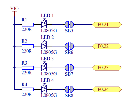

LED works inverse with nrf_gpio_pin_set/clear
When I call nrf_gpio_pin_set(LED_1), the LED is turned off and when I call nrf_gpio_pin_clear(LED_1) it is turned on. Is this expected behaviour? I can't find any schematics for my board so it's not even possible to verify which way the LEDs are connected. I'm using the DK51, and initializing like so:
