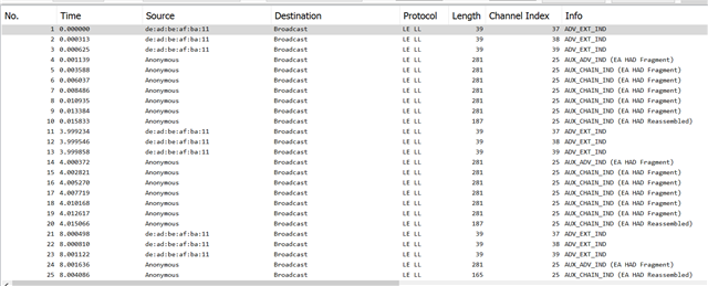

    So basically, I am advertising data that changes dynamically with time. For this, I set the number of events in the advertising data set to 1. For advertising each extended advertising event with updated data, this advertising data set gets re-configured, allowing exactly one event to take place. This ensures that any unique data does not get advertised more than once.
    With the number of advertising events inside the advertising set restricted to 1, this is the sniffer screenshot:
    As you can see, the Auxiliary PDUs are always transmitted on the same channel, indexed 25.

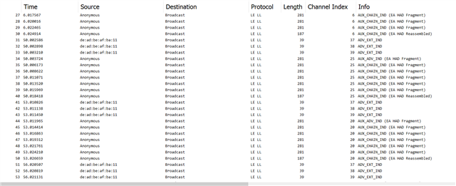

    Looking at your results with Hung's code, I increased the number of events in my code from 1 to 3. This is what I obtained at the sniffer then..
    Now, here, I observed a pattern. The Auxiliary chain channel index changed from 25 to 20 and then to 6 in the first three extended advertising events. After this, the advertising data set got re-configured, and the next three extended advertising events also followed exactly the same pattern of secondary channels 25 -> 20 -> 6.

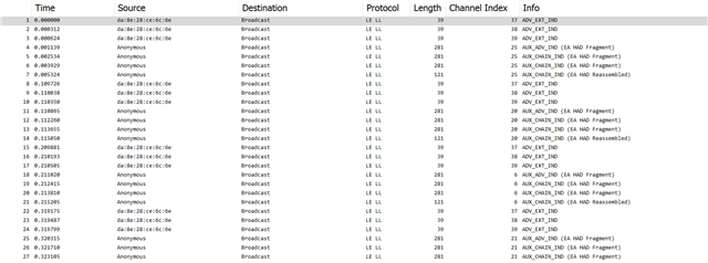

    Next, I also checked the secondary channels with Hung's code, and this was the output:
    Here, the advertising data set got configured only once, in the beginning, and all the events were advertised without the set getting re-configured. Clearly, upon set configuration, the first extended advertising event uses the secondary channel 25, the next one uses 20, next uses 6 and so on.. Exactly the same sequence of secondary channels.

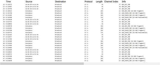

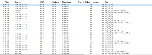

    But, in nRF5 SDK also, I had used the exactly same approach of setting the number of events in an advertising set to 1 and then re-configuring the advertising set for each extended advertising event. But as you can see in the figure attached below, there is no fixed pattern and in fact, the packets within the Auxiliary segment are also advertised on different channels, unlike nRF Connect SDK where the entire auxiliary chain uses the same secondary channel.
    Is there a way to achieve this type of randomization in nRF Connect SDK? If not, is it at least possible to not have a fixed pattern of secondary channels inside the advertising data set? I would definitely not want to advertise the entire data on the same channel.
