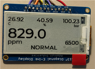

I use in my project Zephyr ssd16xx driver with Waveshare epaper and LVGL and everything seems to be OK, but there is a strange behavior, when the e-paper works longer period (I saw that first, if I forgot my work in progress project running on my desk over night).
If the image is refreshed, then it is OK on the e-paper, but it starts to fade out after refresh. I take some pictures:
This is somewhat OK image, it has a little gray noise and perfect would it be with no noise (when the display stands off a while and then if I try again, then there is no noise on background)
This is after some sec:
I don't know if that is driver side or LVGL side problem. I use CAF for that project and epaper has its own module, where I refresh the data with timer.

  • I used some examples from Zephyr LVGL library. With new Zephyr versions is the grayish color problem also gone.
    SSD1680 and newer chips have waveform table included into the chips ROM and you don't have to write the code to overlay anymore. But I got partial refresh not working anymore -- maybe its better that way -- screen is cleared after every refresh.
