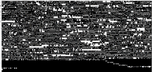

Sniffer using FTDI

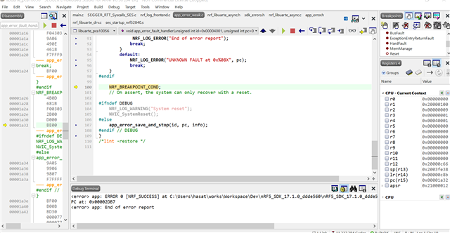

and sometimes the software crashes here NRF_BREAKPOINT_COND

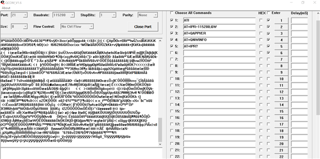

    As UART is asynchronous, the clock on the devices that communicate must not drift too much or bee to inaccurate, as then communication will fail (you will get framing errors, etc). This is a general issue with UART that you need to handle. Also, flow-control is very often a good idea, but for other reasons.
    Lora said:
    I it's between the PC and the modem by the uart of the modem ( NOK)
