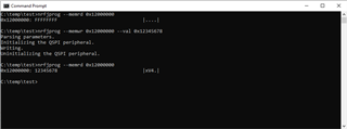

  • Hi Nordic,
    I found nrfjprog can be used to read/write external MX25R6435F QSPI flash.
    Is it also workable for GD25Q16E?
    Does the nrfjprog use page program(cmd: 0x02) to write data ?
    Best Regard,
    Gavin
  • I suggest you play around and test a bit with nrfjprog command line to interface your qspi flash first to ensure that it's electrically correct before you start with the code development.
    For instance you can find there is both an 'nrfjprog --qspieraseall' and 'nrfjprog --readqspi filename' that can be used. Note however that you may need to adjust C:\Program Files (x86)\Nordic Semiconductor\nrf-command-line-tools\share\QspiDefault.ini file in a text editor to fit with your hardware layout.
    For instance in the .ini file I suggest you try with Frequency = M2
    Remember to take a copy of the .ini file.
    Kenneth

  • Hi Kenneth,
    I tested on our pcb and got these log.
    C:\Users\Gavin>nrfjprog --memrd 0x12000000
    ERROR: Unable to connect to a debugger.
    ERROR: JLinkARM DLL reported an error. Try again. If error condition
    ERROR: persists, run the same command again with argument --log, contact Nordic
    ERROR: Semiconductor and provide the generated log.log file to them.
    NOTE: For additional output, try running again with logging enabled (--log).
    NOTE: Any generated log error messages will be displayed.
    Does it mean QSPI interface not correct?
    Gavin
  • That error sounds like a more generic error with the connection between jlink and nRF52. Does any other nrfjprog command work? E.g. how about just reading internal flash of the nRF52 using nrfjprog --memrd 0
    What does it say if you call nrfjprog --version
    If you are able to read using nrfjprog --memrd 0, then it sounds to be a error of the qspi interface yes. Though you can run the qspi commands on an DK for comparison also.
    Though you have not told me if the 'nrfjprog --qspieraseall' and 'nrfjprog --readqspi filename' did succeed.
    Kenneth
