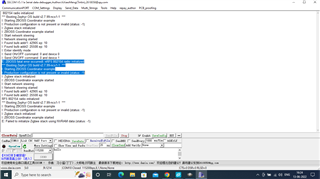

hi,
i m working to create a zigbee network using demo example of light bulb given in sample project of nrf5340dk.
as of now i am able to connect 2-3 bulb devices(i.e. zigbee routers) with single zigbee coordinator, now i am having issues with sending command using zigbee coordinator, when i send the command, it gives zigbee fatal error. as shown in the logs below.  and system reset automatically.
if i connect only one zigbee bulb device , it works fine this same code.

                //LOG_INF("size %d", size);
                for (int i = 0; i <=size; i++)
                     if (buf_addr[i] == bulb_ctx.short_addr)
                          isElementPresent = 1;
                if (isElementPresent!=1)
                 count++;
                 buf_addr[size] = bulb_ctx.short_addr;
                 LOG_INF("Found bulb addr%d: %d ep: %d", count, bulb_ctx.short_addr, bulb_ctx.endpoint);
		//k_timer_stop(&bulb_ctx.find_alarm);
		//dk_set_led_on(BULB_FOUND_LED);
        else {
           //if()
		//LOG_INF("Bulb not found, try again");
	if (bufid) {
		zb_buf_free(bufid);
static void find_light_bulb(zb_bufid_t bufid)
	zb_zdo_match_desc_param_t *req;
	/* Initialize pointers inside buffer and reserve space for
	 * zb_zdo_match_desc_param_t request.
	req = zb_buf_initial_alloc(bufid,
		sizeof(zb_zdo_match_desc_param_t) + (1) * sizeof(zb_uint16_t));
	req->nwk_addr         = MATCH_DESC_REQ_ROLE;
	req->addr_of_interest = MATCH_DESC_REQ_ROLE;
	req->profile_id       = ZB_AF_HA_PROFILE_ID;
	/* We are searching for 2 clusters: On/Off and Level Control Server. */
	req->num_in_clusters  = 2;
	req->num_out_clusters = 0;
	req->cluster_list[0]  = ZB_ZCL_CLUSTER_ID_ON_OFF;
	req->cluster_list[1]  = ZB_ZCL_CLUSTER_ID_LEVEL_CONTROL;
	/* Set 0xFFFF to reset short address in order to parse
	 * only one response.
	//bulb_ctx.short_addr = 0xFFFF;
	(void)zb_zdo_match_desc_req(bufid, find_light_bulb_cb);
/**@brief Find bulb allarm handler.
 * @param[in]   timer   Address of timer.
static void find_light_bulb_alarm(struct k_timer *timer)
	ZB_ERROR_CHECK(zb_buf_get_out_delayed(find_light_bulb));
static void light_switch_send_on_off(zb_bufid_t bufid, zb_uint16_t cmd_id)
   static uint8_t length1 = 0;
   for(int i=0;i<10;i++)
       if(buf_addr[i]==0)
           length1 = i;
  uint8_t i;
  for(i=0;i<length1;i++)
        LOG_INF("Send ON/OFF command: %d and device %d", cmd_id, i);
	ZB_ZCL_ON_OFF_SEND_REQ(bufid,
			       buf_addr[i],
			       ZB_APS_ADDR_MODE_16_ENDP_PRESENT,
			       bulb_ctx.endpoint,
			       ZIGBEE_COORDINATOR_ENDPOINT,
			       ZB_AF_HA_PROFILE_ID,
			       ZB_ZCL_DISABLE_DEFAULT_RESPONSE,
			       cmd_id,
			       NULL);
void main(void)
	int blink_status = 0;
	LOG_INF("Starting ZBOSS Coordinator example");
        alarm_timers_init();
	/* Initialize */
	configure_gpio();
	/* Register device context (endpoints). */
	ZB_AF_REGISTER_DEVICE_CTX(&nwk_coordinator);
	app_clusters_attr_init();
	/* Register handlers to identify notifications. */
	ZB_AF_SET_IDENTIFY_NOTIFICATION_HANDLER(ZIGBEE_COORDINATOR_ENDPOINT, identify_cb);
	/* Start Zigbee default thread */
	zigbee_enable();
	LOG_INF("ZBOSS Coordinator example started");
	while (1) {
		dk_set_led(RUN_STATUS_LED, (++blink_status) % 2);
		k_sleep(K_MSEC(RUN_LED_BLINK_INTERVAL));
    So when zb_buf_get_out_delayed_ext() returns something other than RET_OK, and you pass that return value into ZB_ERROR_CHECK() it will reset with this "fatal error" message.
    Try to rather check the return value. According to the declaration of zb_buf_get_out_delayed_ext() it can return either RET_OK or RET_OVERFLOW. Try something like this:
                zb_err_code = zb_buf_get_out_delayed_ext(light_switch_send_on_off, cmd_id, 0);
    			if (zb_err_code == RET_OVERFLOW)
    			    LOG_INF("not scheduled. Try again later...");
    			else
    			    ZB_ERROR_CHECK(zb_err_code);
    See if that helps.
    Edvin
    			else
    See if that helps.
    Edvin
