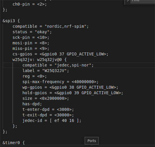

I'm using nrf9160 with Zephyr RTOS i need to interface external flash memory using SPI protocol.
but, I didn't get any example code for that. can you help me to find example code for SPI protocol using nrf9160 with Zephyr RTOS.

I believe the spi_flash sample in zephyr\samples\drivers can be used with some minor modifications. You can try that, and let me know if you get stuck.

There are some boards that uses the W25Q32JV. You can take a look at how these boards have added W25Q32JV to the devicetree. E.g:

github.com/.../sparkfun_thing_plus_nrf9160_common.dtsthanks it really helpful for me. I got that but my qurey still not resloved.
as i mention in query i want to configure SPI in my code but I'm not getting any idea to configure SPI.
can you give any idea how to configure SPI in my code...?

_bhanu said:can you give any idea how to configure SPI in my code...?
You can change the SPI node fields(pins to use, frequency , etc) in the devicetree
yes i did it, but I'm still not getting any idea how to implement in main.c
so,can you help to get any example main.c code based on "W25Q32JV SPI FLASH".
