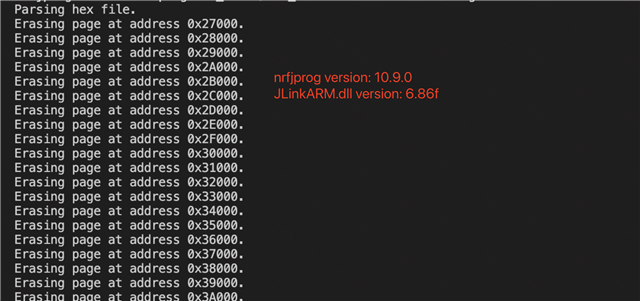

Hello, i installed nrfjprog version: 10.14.0 external, JLinkARM.dll version: 6.86f. When i download hex file use nrfjprog -f, there is no log like erase 0xxxxx. How can i fix it.Thanks.
I am not familiar with this earlier version, but the newer version of nrfjprog does not provide this log on what pages get erased from flashing an application.
If you want more information and output from nrfjprog you can use the '--log' argument and check the log.log file.
