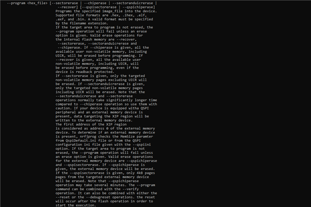

    So now I have an problem with Segger Jlink. How can I dont erase flash memory before upload my code.
    May I try "upload range" ? I'm using nRF52833 and what is range that I have to modify ?
    Do you reprogram the chip between or do you only reset it?
