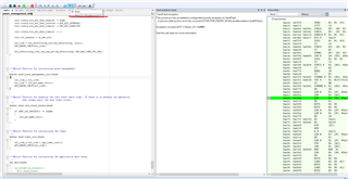

  • Here i get the hardfault, if i download and debug:
    if I reset it and run it again i still get hardfault:

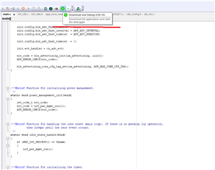

    But if I debug without downloading:
    sd_softdevice_enable return 8.
    I i erase the chip it will work just once:
    if i reset it i get the same error code:
