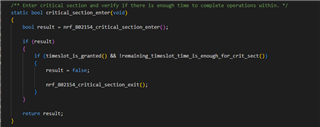

According to the INFO = 2 message. There seems to be the radio peripheral violation. After I dumped assembly form   .elf   file. The pc address 0x76ad6 points to a branch in nrf_802154_core.c file.
The .c file is as below.

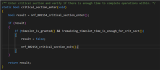

Then I added a print(); function before result = false;  then I can't see any messages. Then I print the
nrf_802154_rsch_timeslot_us_left_get() , it indeed >MAX_CRIT_SECT_TIME.
After I added the print(); funciton, The PC changed ,but it still stoped at nRF-IEEE-802.15.4-radio-driver. If I comment out the ble_advertising_stop_nrf52840(void) function, it works fine.

  • KelvinCGCG said:
    I mean nrf_802154_rsch_timeslot_us_left_get() >= MAX_CRIT_SECT_TIME;
    So this means that when you do this measurement, you still have enough time. Adding an RTOS complicates things a bit. It adds delays that you may or may not have control over. I am not at all familiar with CONTIKI, but could the case be that you measure the nrf_802154_rsch_timeslot_us_left_get(), there is still enough time in the timeslot, and then you start to perform your task. But if you are interrupted by something in the OS, and the remaining time runs out before you finish your task, and you don't have time to leave the timeslot before it runs out, then this will cause the kind of assert that you are seeing.
    I don't know what your project looks like. Where do you exit your critical timeslot? If you add a log there as well, you should see that they will enter and exit every other time. Is the last thing that happens before the issue that it enters or exits a critical section?
    I don't know whether it is relevant or not, but have you tried upgrading to SDK17.1.0 to see if that helps? I do remember seeing some bugs in the timeslots when using 802154, but I don't remember if that was using this driver, or something else.
