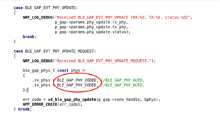

Initial testing works, i.e. I can upload a new image successfully, but was worried that a BLE_GAP_EVT_PHY_UPDATE may be issued by the DFU loader app, and it still actually using the 1MBPS_PHY. I have validated the work as following
  • Check with NRF-Connect that both the primary and secondary phy are configured as LE Coded
  • Check the debug output of the DFU to see if a PHY change was requested - none are seen
  • Compared upload time between 1MB and CODED_PHY.  CODED_PHY was significantly slower as expected
  • Tried using a phone which does not support CODED_PHY - does not work although this may not be conclusive if a PHY change happens.
  • Check the log output of the DFU app using the NRF-Logger app. - I can see there is a request for preferred phy 1MB/2MB but I don't see a response on that. (and as per my point above, no logs about this being received/actioned on the DFU).

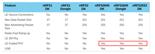

I don't have a good BLE Sniffer to see if the packets are actually CODED or not so just wondering if someone else has tried the same, and if there are any better ways to confirm this.

    The central device will normally not request a PHY update when the connection is established with CODED PHY as in your case (central must establish the connection using the same PHY as the secondary adv. channel). But if you do get this request during the connection, then you can always just reply with BLE_GAP_PHY_CODED to reject it:
    You can also monitor the BLE_GAP_EVT_PHY_UPDATE event. This event will be raised if the PHY is updated: PHY Update Procedure.
    Just want to add that the nRF Sniffer does support coded PHY if you use it with one of the supported boards:
