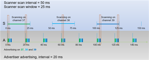

Hello, I have a question.
I am developing with nrf52832 (s132 v7.0.1, SDK v17.0.0) as a peripheral.
I have a question about the output time of the advertisements.
The BLE outputs advertisements for channels 37, 38, and 39. I would like to know how long it takes to output advertisements to these channels.
How is the time spent sending advertisements for a single channel determined?
Also, is it possible to set the time?
I tried looking for a code to set the time, but could not find one. Therefore, I am thinking that there is a standard time and that the time to transmit may vary depending on something.
Please help me solve this problem.
