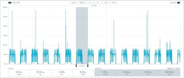

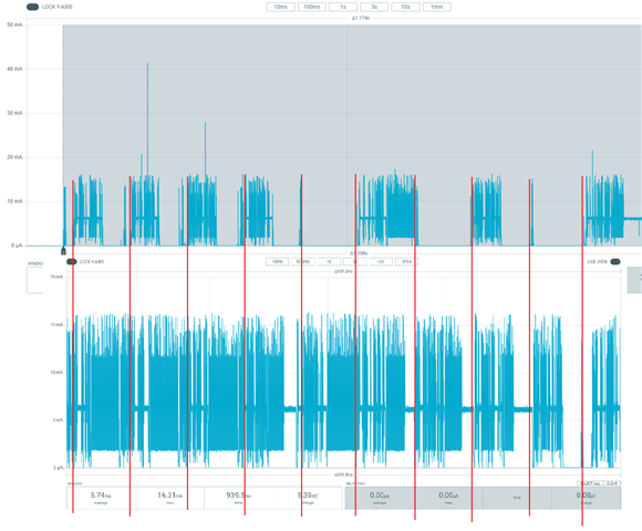

    But, after looking closer at the Power profiler plots, it seems like the scan window might be causing trouble for you. The scanning process in the two scenarios draw ~2.5mA and ~5.5mA which is huge.
    If you compare the scanning plots you see that it scans with ~100 duty cycle on the last plot, vs. ~50% on the first one, see picture above. The red lines mark 100ms intervals. You say that the duty cycle of scanning is at 50% with Scan_Interval = 100ms and Scan_window = 50ms, which means that the top one is what we would expect, but it does seem like it still skips some scanning cycles and are sometimes "stuck" for 100ms.
    So it seems like the scanning might not work as intended, either due to the advertising aborting scanning, or by itself. Can you double check that the scan_window is indeed set to 50ms for both scenarios, and try turning off advertising entirely, and see if the scan windows for different intervals seem more correct then?

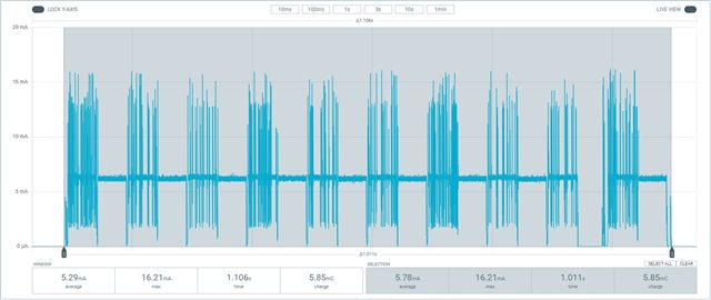

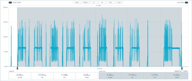

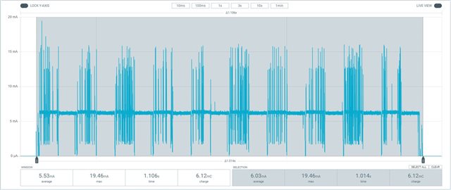

    Only Scan:
    Scan + Adv 3s interval:
    Scan + Adv 100ms interval:
    We can discuss the optimization problem but let's focus on the consumption problem.

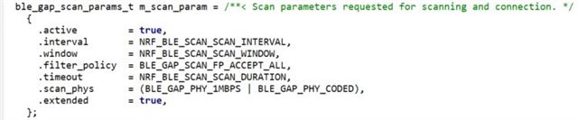

    I wanted a point of comparison. so I used the example code
    ble_app_blinky_c_pca10056_s140.hex
    We can observe a difference with my graphs which, after some research, turns out
    to come from the configuration of the scan and more precisely from
    ble_gap_scan_params_t.scan_phys
    The only place the scan configuration is changed is here to change the scan duration

  • Hi again

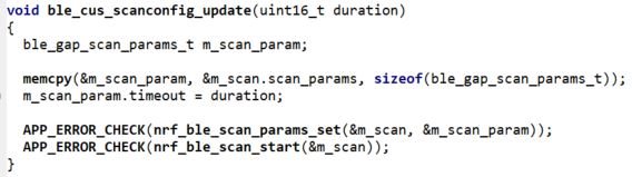

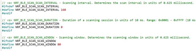

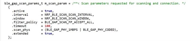

    You say that your scan duration is set to 1 second, but the NRF_BLE_SCAN_SCAN_DURATION seems to be set to 0 (looping forever) in your sdk_config.h file (that shouldn't be the issue though, but more for your information). I think it would be better to change this define to 1 second instead of using the ble_cus_scanconfig_update() function you made yourself. Did you disable advertising altogether for your "Only Scan" power profiler trace, because it seems almost identical to the 3s adv interval trace? Please make sure you disable/remove all mentions of advertising (both init, start, uninit, and so on).
    Simon

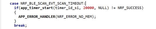

    Indeed, the default scan configuration is 0 (looping forever) but as you noted, I use the ble_cus_scanconfig_update() function to change it to 1s. To avoid any problem related to my application code, I therefore used the following configuration during my tests:
    Yes, I correctly removed all traces of advertising during my "OnlyScan" test, I even checked on the nRF Connect app that my device was no longer visible.
    Knowing that scan lasts 1s and that advertising is configured at 3s interval. I just think that on the "Scan + Adv 3s Interval" scheme, we fall between two advertisements, which explains the similarities with the "OnlyScan" scheme.
  • Okay, it still seems like the scanning in these two plots are scanning with a 100% duty cycle (scanning continuously). Can you try reading out the duty cycle (scan window) value when only scanning, as it doesn't seem to be set to 50ms. It only seems to be the advertisements in the 100ms that actually stops the scanning every 100ms, so something seems to be wrong with the duty cycle when the advertiser doesn't run. Do you see the same if you modify a pure central application as well (for example the Nordic UART service Client)?
