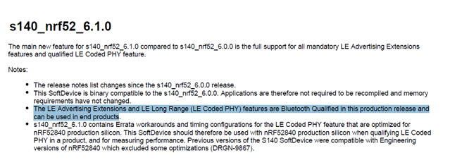

Right now our application developed using s140_nrf52_6.0.0_softdevice, SDK 15.0.0 for NRF52840 chip.
Need help on migrating to BLE 5.
  1. Which SDK & soft device to be used. Would be great if the compatibility matrix link shred.
  2. Memory foot print for the supported sdk and soft device.
Reedomneck`

    You need to be more specific on the features that you are looking for. For example speed, what speed ?
    In the list you provided , only point 6 is not supported. It's not supported in all softdevice including the latest one.
    But it's supported in nRF Connect SDK which is our new SDK.
